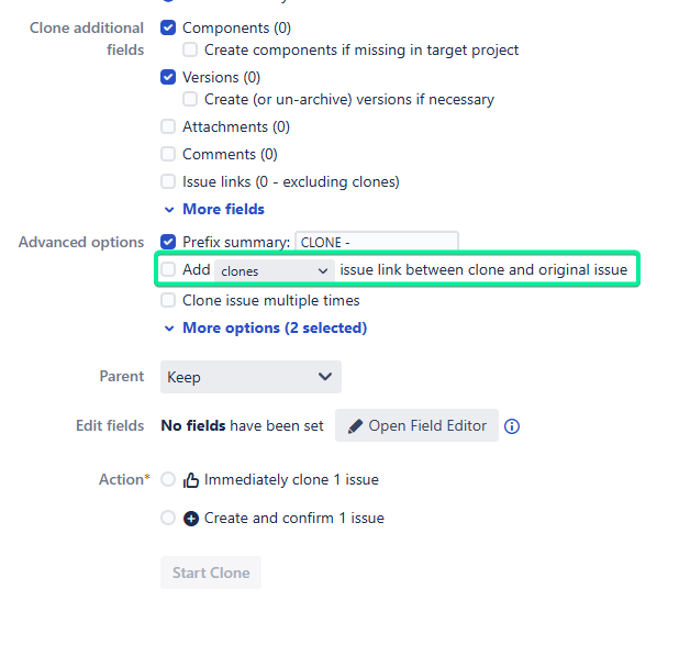

Jira automatically adds a "clones" issue link between the original and cloned issues when using the standard Clone function. If you'd like to prevent this link from being created when cloning issues, our app Deep Clone for Jira offers a flexible solution.
With Deep Clone, you can simply uncheck the option Add issue links between clone and original issue.

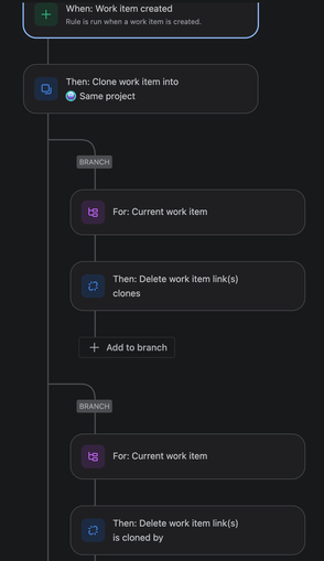

On cloning by design the a link is set between the original work item and the cloned item.
Are you cloning via automation or the cloning option on the issue?
If you would use an automation rule to clone a work item, you could try to set a branch in the rule and base the branch on the most recently created work item and then delete the link and a branch on current item and delete the link

Hey @Marc - Devoteam thanks for reaching out - I have set a master work item that team members can essentially clone (including tasks and sub-tasks) to reduce manual effort on repeat tasks.
It looks like the rule you have above would clone a work item into the same project every time? If so that wouldn't work, I essentially just wanted to remove any inherent association between the master work item and the one they will clone, as there's no requirement for them to be linked.

This is an example, adjust this to your needs.
