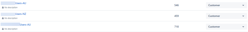

We now have the below 3 groups that users are automatically put into when they start with the company (Externally synced), which gives them the same access as the above default JIRA group to our Staff Portal.

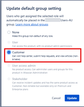

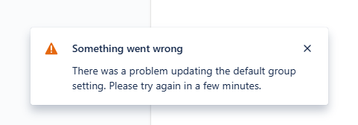

The three groups are externally synced groups, which from what I have read cannot be made default, below is what I get when I try and make them default -
Even waiting a few mins, hours, overnight does not allow me to make these three groups default.

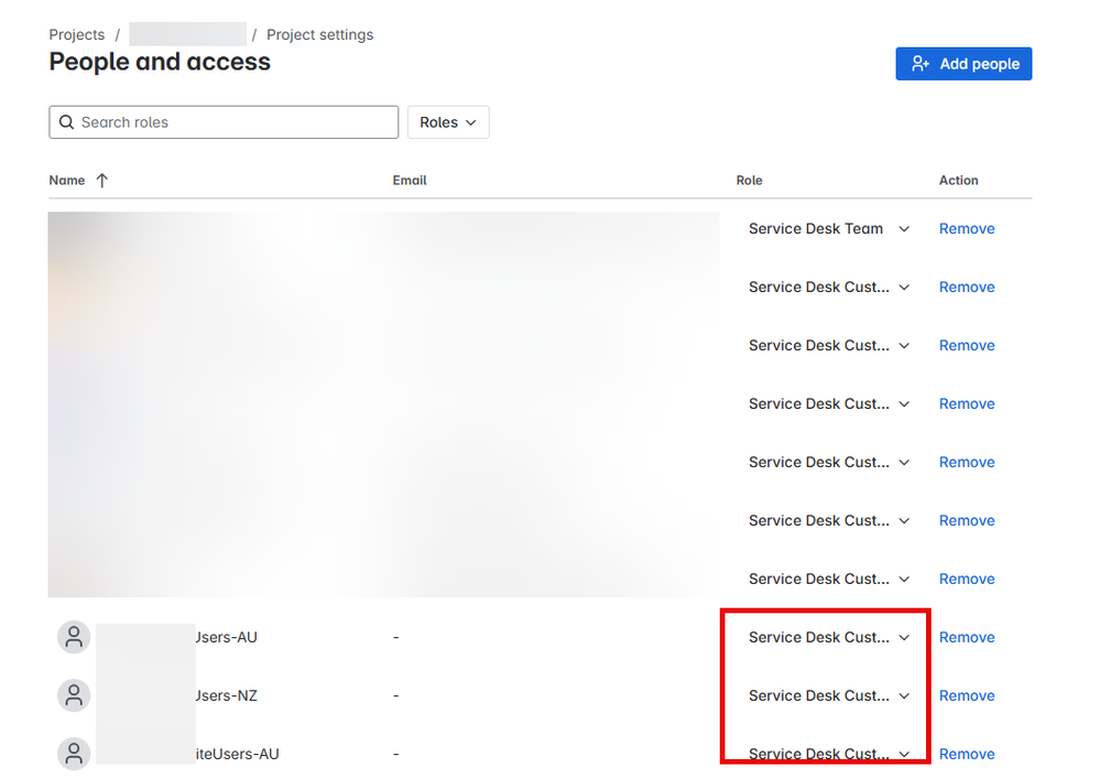

All three groups have customer permissions within the Projects themselves as well -

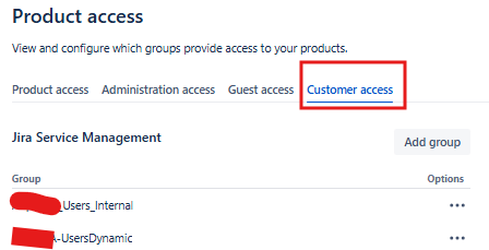

@Joshua Stokes If you want these three groups to be added as a customer access OR users from these group should be treated as a Customer by default then you can add them in the Product access --> Customer access.
In the below snaps, if you see these group are the external identity groups and added to the customer access.

We are on Enterprise plan and we have more than one site, hence we can see this customer access under the products -->  product access etc
If you have only single site then you wont see this that to be on Premium plan

You need to grant these new managed groups the customer permission on the JSM project in the access setting of the project.
