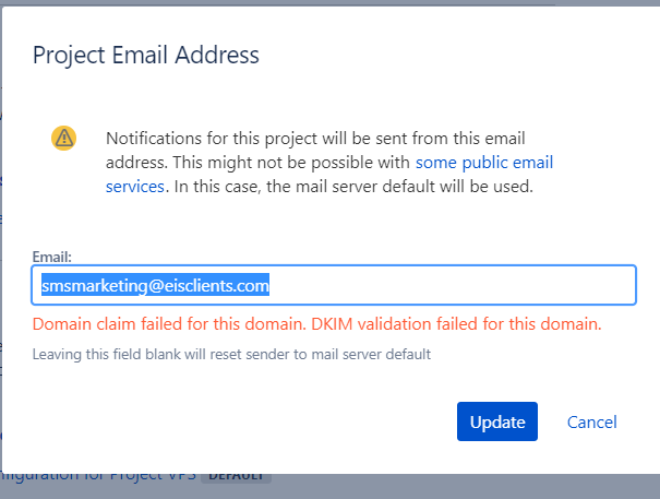

I tried editing the Project email address  to the configured email address, from Notification scheme, but got the below error message. Please advice how it can be done

For a reply to be added as a comment on a ticket, the person who is replying must have permission on the ticket. For them to be able to comment on the ticket, the reporter or an agent must add them as a participant of the ticket.
Related to the Project Email Address, it's possible to change, but it's necessary to verify the domain first.
For more details on how to change this email address, please check the documentation below:

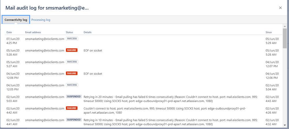

Yes, there are errors in the log. Please suggest what to be done to resolve this issue?
Angélica Luz
June 8, 2020
Thank you for the screenshot.
This indeed can be related to the issue because the mail handler didn't work for a while and then it connected again.
Usually, this error is related to MFA or 2FA. If that's the case, please check our documentation and set up an app password.
Please, also check the tab "Processing log" that will show the emails from customers that failed to create a ticket. If it shows any error, please share the screenshot with us, just make sure to hide their email addresses.

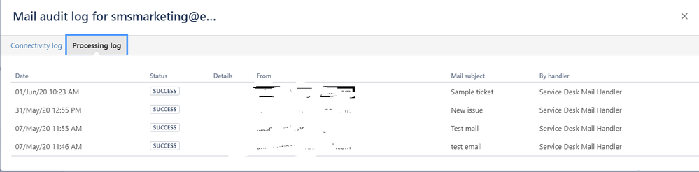

Please find below screenshot for Processing Log
As mentioned earlier, Issue is not in ticket creation. For every email received, there is a corresponding ticket being generated on the Service desk Project. But customer email replies are lost as it is not getting appended as comments in the Jira Ticket.

Thank you for sharing the screenshot.
The processing log shows new tickets but also replies but it seems that the replies are not evening being received by Jira. If it would, the "Mail subject" column would show, for example, "Re: TEST-123 Sample ticket" informing that it was a reply for the ticket "Sample ticket" and containing the issue key.
Does anyone else have access to the email inbox?
Jira reads all the emails on the inbox, so when the email is not being received by Jira, the most common cause is that someone else is reading the email before Jira does.
Please, make sure that the email is used exclusively for Jira, if possible, change the password, so anyone that has access through the browser or mobile is logged out and then we can confirm that only Jira is reading the emails.
