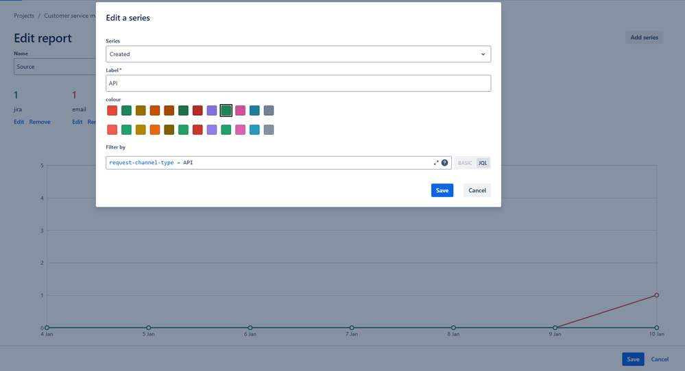

Hi @Ender P_
Thanks for sharing the screenshot!
I guess Slack is not shown in the list as its' integration is not fully configured and it might need additional configuration for the issues to reflect Slack as a channel.
To check that you need to confirm from Apps section, that the Slack app/integration is properly installed and linked to your Slack workspace.
