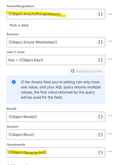

See picture, the rule shows a completely different date, but why? The date format for “Garantieende” should be exactly the same as for “Anschaffungsdatum”, it is also the same field, why is it different?

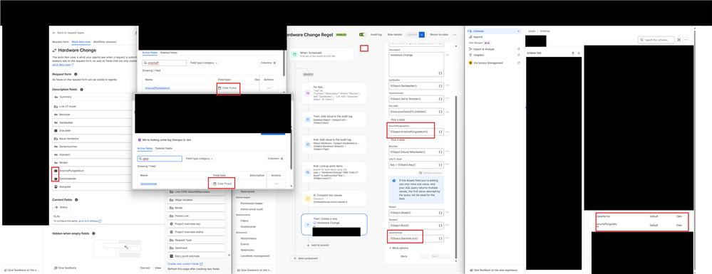

They both are just date pickers.

No they are not date pickers, It's information stored in an asset object attribute.
You will need to see the asset schema used and check the attribute type used on the object type
The attribute Garantie Bis, is of  type Date Time attribute and the attribute Anschaffungsdatum is of type Date

look at my screenshot, please:

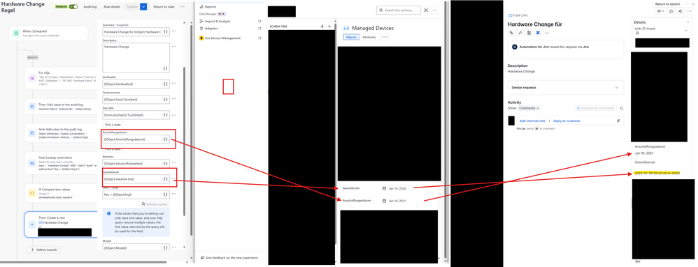

The thing is, I deleted "Garantieende" again and added it back and now the rule gives an error message:
"We excluded the configured field from this action as it couldn't be found:
Garantieende"
I haven't actually done anything different, so no idea why the field isn't found.

The custom field Garantieende is probably of the date/time type as well. and not type Date
You will have to create this custom field again with the right type and the correct asset config.

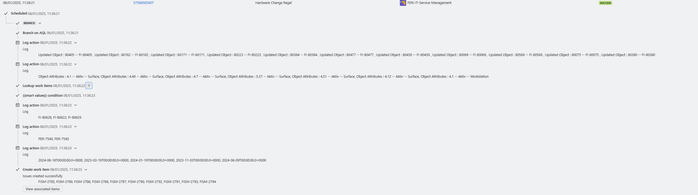

What does the audit log mention when the rule runs?
Marc - Devoteam
August 1, 2025
Hi @Antonia
In the log you see that the values are still date time.
Where does this information come from are these attributes from other objects you are copying?
If so what type are these attributes?

Hi @Antonia
Check how those fields are presented in ticket via Rest API. To fix this I would suggest to use .format() function to be sure that all fields have same format. https://support.atlassian.com/cloud-automation/docs/jira-smart-values-date-and-time/#Date-format---
