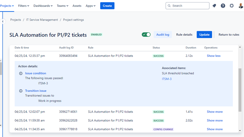

Instead of checking issues raised between 9-5, Mon-Fri, you can use the SLA breach condition in automation. I have built one for your use case and you can try if that works. I am attaching the screenshots document below, Hope this helps !
Vijay
Here you can see automation has run successfully and moved issue status to in progress.
Vj

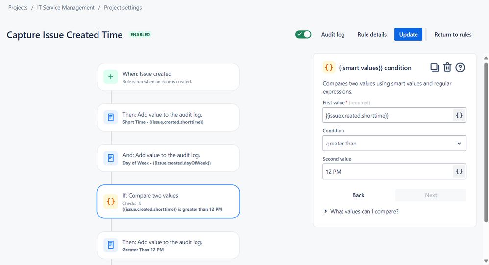

Hello @George Bliss ,
Here is how I achieved it. I used
{{issue.created.shorttime}} which returns values like 1 AM, 2 AM, 3 AM, 3 AM
[{issue.created.weekOfDay}} which returns values like 1,2,3,4,5,6,7
Monday 1
Tuesday 2
Wednesday 3
Thursday 4
Friday 5
Saturday 6
Sunday 7
Now i can put jql condition like ({{issue.created.weekOfDay}} >=1) AND ({{issue.created.weekOfDay}} <6 ) AND ({{issue.created.shorttime}}>= 9 AM ) AND ({{issue.created.shorttime}}< 5 PM)
At the end you put edit issue step and set the status to In Progress.
Hope it helps !
Vijay
