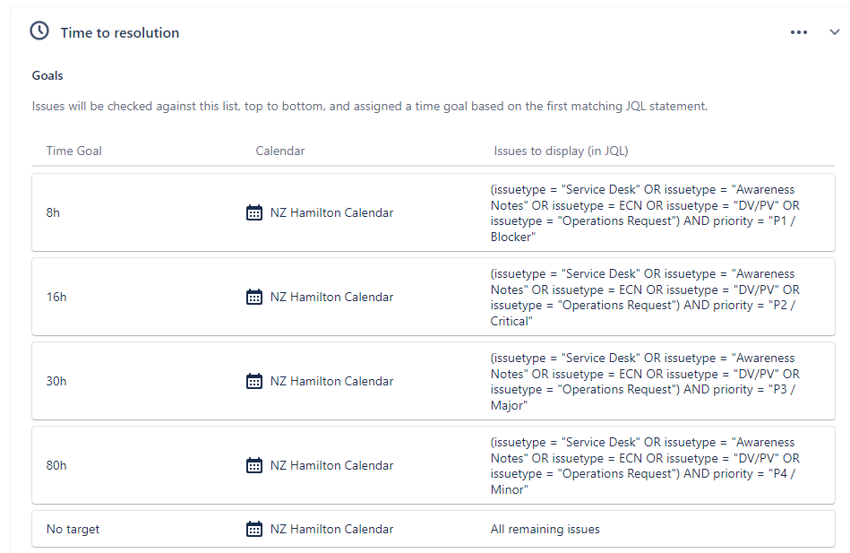

Hi There
Thank you for your reply. So we have two SLAs for this project. One is "Time to first response" and the other is "Time to resolution.
Here is the "Time to first response" SLA and the issue type that it's not populating for is "Operations Request" .
This is the SLA for "Time to Resolution" SLA and the conditions.

Hey, @Aamina Reihana
I replicated the scenario you are using in the 2h SLA.
The error is in the OR condition of your JQL. For SLA's, when it comes to including more than one value for the same field, we use the IN function and not the OR.
Try using the following JQL in your 2h SLA:
issuetype in ("Service Desk", "Awareness Notes", "ECN", "DV/PV", "Operations Request")
Each issuetype is separated by a quote(") and a comma(,)
I believe that for the first case this will work. Then just replicate the same "IN" condition for the other SLA's.
For the other SLAs of 8h, 16h, 30h and 80h use the same IN condition.
For example the 80h:
issuetype in ("Service Desk", "Awareness Notes", "ECN", "DV/PV", "Operations Request") AND priority = P4/Minor
Just apply this "IN" setting to the others and I believe it will work.
