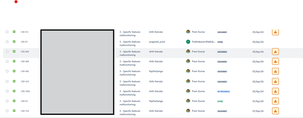

I have setup the SLA for my Project in JSM as per the screenshot below. But the SLA is not getting calculated. What could be the issue?
The column in your screenshot with the warning triangle is that where you have the SLA displayed? Normally when you add a new SLA the issues will recalculate and that can just take some time.
If they are displaying that warning triangle it just means they are still calculating. The SLA needs to go and check each issue to see if they are valid for the SLA/goals so depending on the project it can take a little while for it to appear.
Since you posted this 10h ago is this still an issue or did they appear?
If you open one of the issues what does the SLA panel say there?
Hi Dirk, I see the same status for more than a week. The number of tickets i have in this project are not even 1000 in total.
Below is the message shown,
Could not load SLA.
SLA may be indexing due to configuration updates. If this persists, check the SLA configuration.
Our SLAs are based on the field Severity and all values in the field are covered in the SLA definition.
Have you check to see if your issues associated with your specified JQL (goal setup) are in the riight WF statuses - because looking at your conditions setup that will be where the counting will start/pulsed/end?
Also what is the error massages associated with the warning symbol?
Please advise.

@Joseph Chung Yin Below is the error
Could not load SLA.
