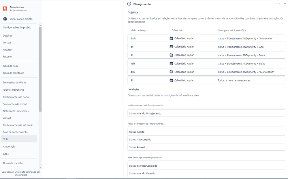

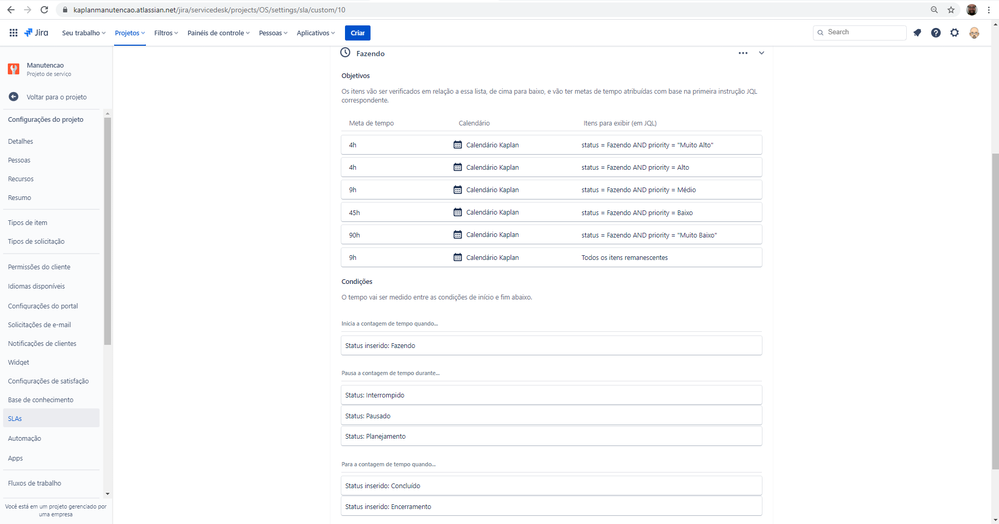

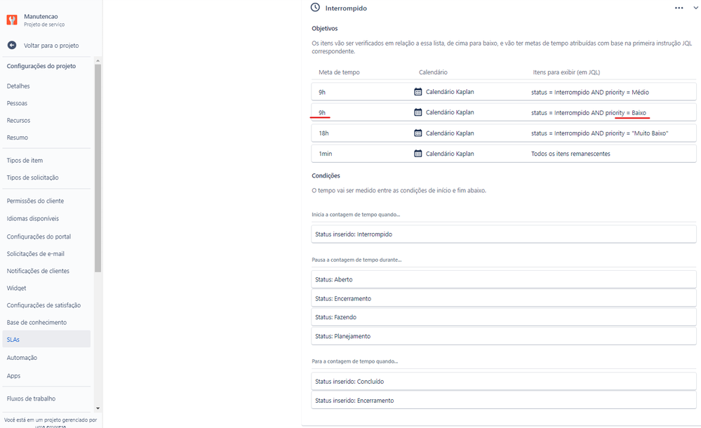

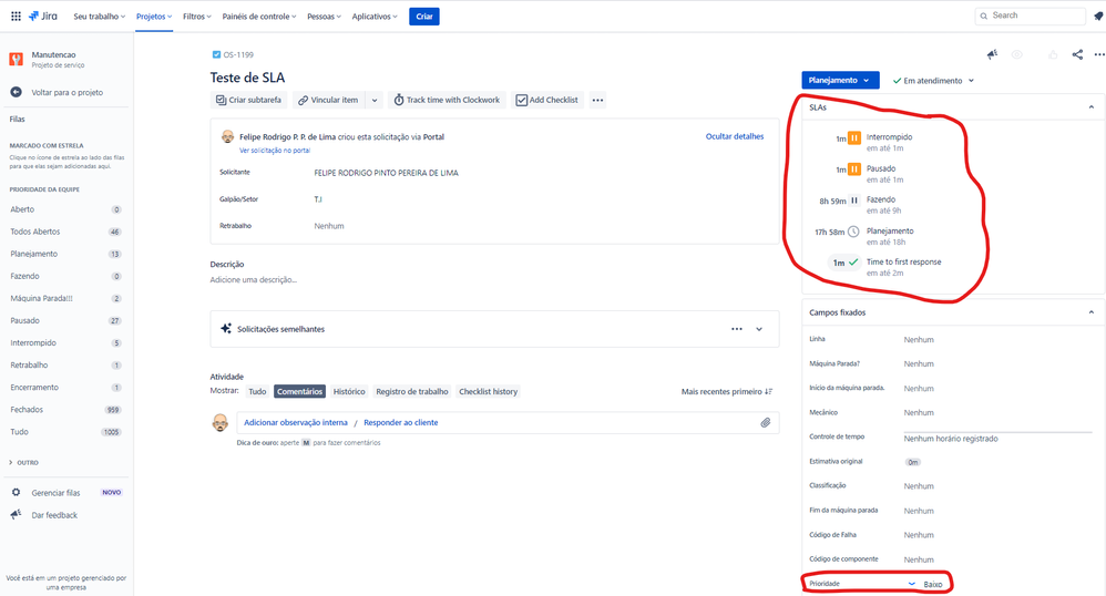

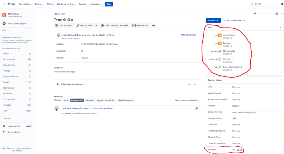

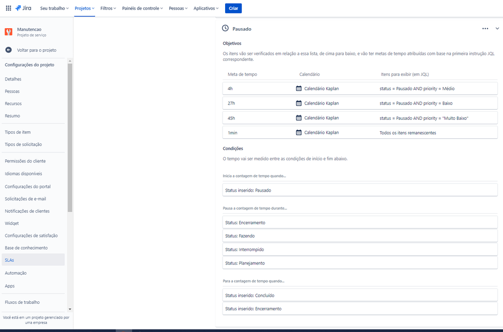

My SLA is set, but as we change statuses, the SLA is changing to the wrong value. As the screenshot below while I was in the status "Planejamento" and priority "Baixo" is showing 18h that is correct, but when I change to the status "Fazendo" the value of the SLA is wrong, as if it were in the priority "Médio". Also the statuses "Interrompido" and "Pausado" are also wrong. They are like all the remaining items.
Fazendo 2021-09-21 132910.pngPlanejamento 2021-09-21 132814.pngSLA Fazendo 2021-09-21 133722.pngSLA Interrompido 2021-09-21 134027.pngSLA Pausado 2021-09-21 134107.pngSLA Planejamento 2021-09-21 132529.png

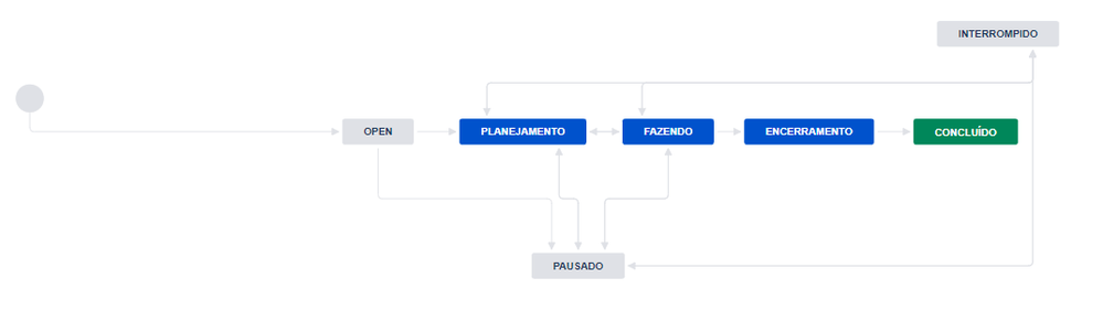

Here is my Workflow:

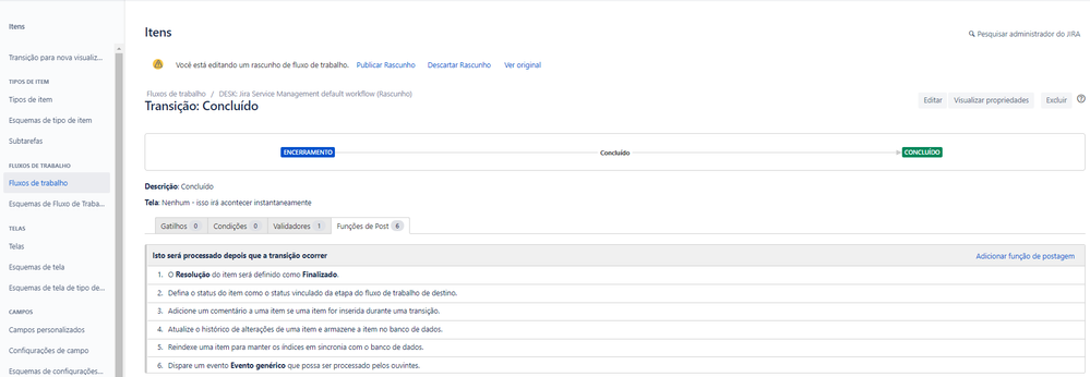

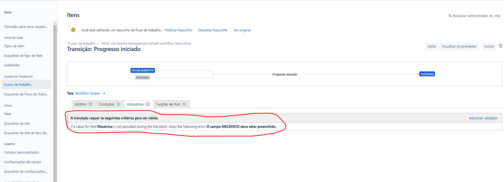

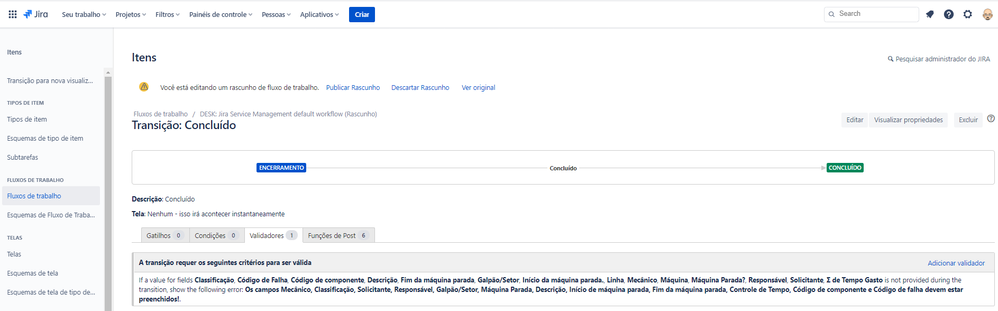

I have a validator from the status "Planejamento" to the status "Fazendo" and other validators from the status "Encerramento" to "Concluído", I also have a post function to change the Resolution to "Finalizado", but I believe they are not responsible for this problem:
Função de Post Encerramento Concluído 2021-09-21 135254.pngValidador Encerramento Concluído 2021-09-21 135200.pngValidador Planejamento Fazendo 2021-09-21 134817.png

Hello @Felipe Rodrigo P. P. de Lima,

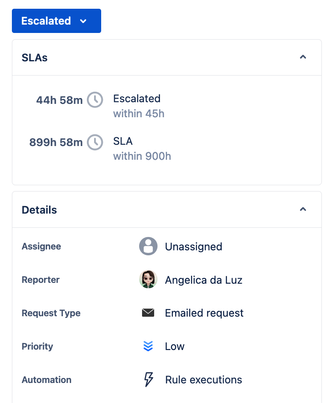

Testing on my local site, I created two new SLAs and used the same JQL as you and I was able to replicate the same issue.

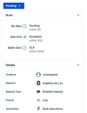

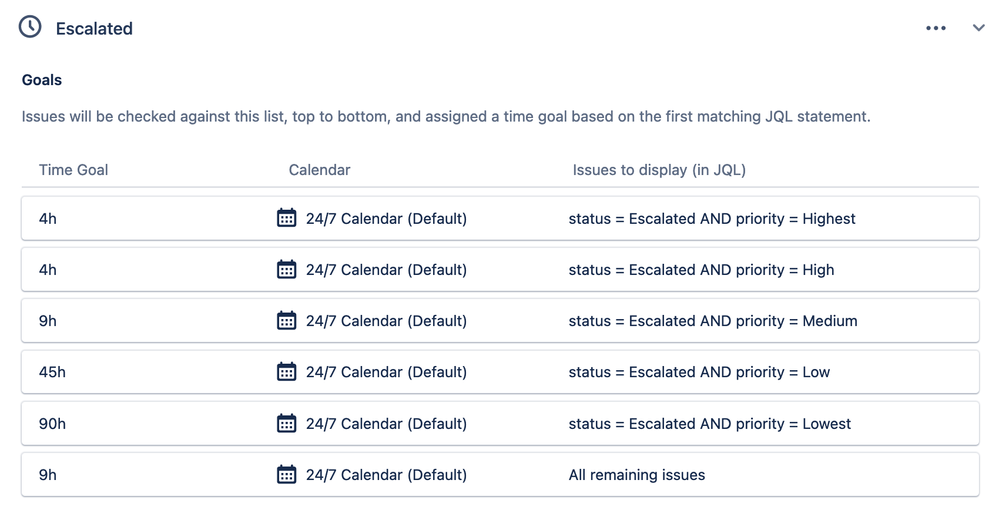

I created a ticket with the priority Low and then, and the SLA was showing correctly (45h remaining). Once I transitioned from Escalated to Pending, the SLA somehow “inherited” the goal from the Pending SLA where the goal for Low priority is 9h.

Ticket transitioned to Escalated showing the correct SLA:

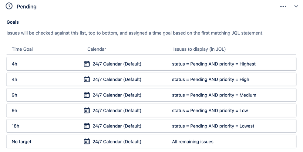

Ticket transitioned to Pending where the SLA for Low priority is 9h:

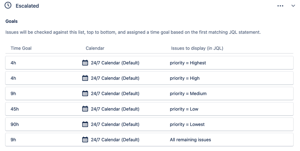

After that, I edited all JQLs on each goal and removed the “status = Escalated AND”/“status = Pending AND” and just let the priority and it fixed the issue.
SLAs of the same ticket after editing the JQL:
Since the SLA is already set to start when “Entered the status: Fazendo” or  “Interrompido”, then it’s not necessary to also filter the status on the JQL.
Please, edit the JQL on all SLAs and let only “priority = priority-name”:
