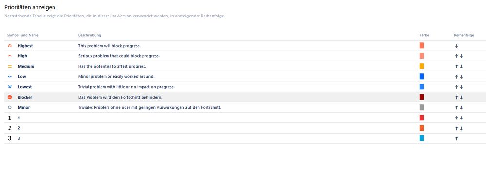

I'm using cutom prios. Besause of this I'm not able to create an SLA with this prios in the jql.
In any case it dosn't work. When I delte the prio or use the syste, prio the SLA soon is working.
What am I doing wrong.
Thx

thx so far. this is the jql:
issuetype = Vorfall AND priority = 1
I only use the numbers
The SLA will not be displayed and there is no error or anything else
Can you try
issuetype = Vorfall AND priority = "1"
It might be, that the 1 without "" is interpreted as the id and not the name of the priority.
Your idea abaout die ID was not so bad. I changed the the way :-) Now I took the origin ID of the lable (in case 10100) and it is working
The correct JQL for this is: issuetype = Vorfall AND priority = "10100"
