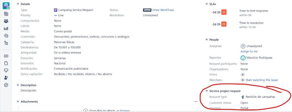

Hi Charlie.
I need to hide some fields in Jira Screen depends of request type value.
I find the following article but is not working.
However, the documentation you've given me indicates that it's not possible to get the value of the Request Type field using a script.
Following you could see the script I built. (Behaviours)
