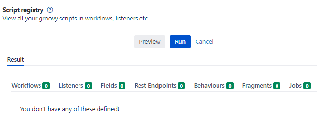

Thank you for suggesting "Script Registry" ... it looks like we aren't using it on the workflows.Screenshot 2021-01-13 144712.pngThank you also for suggesting the filter check.
Tansu Akdeniz
January 13, 2021
You are welcome. It looks like there is no active plugin usage.
