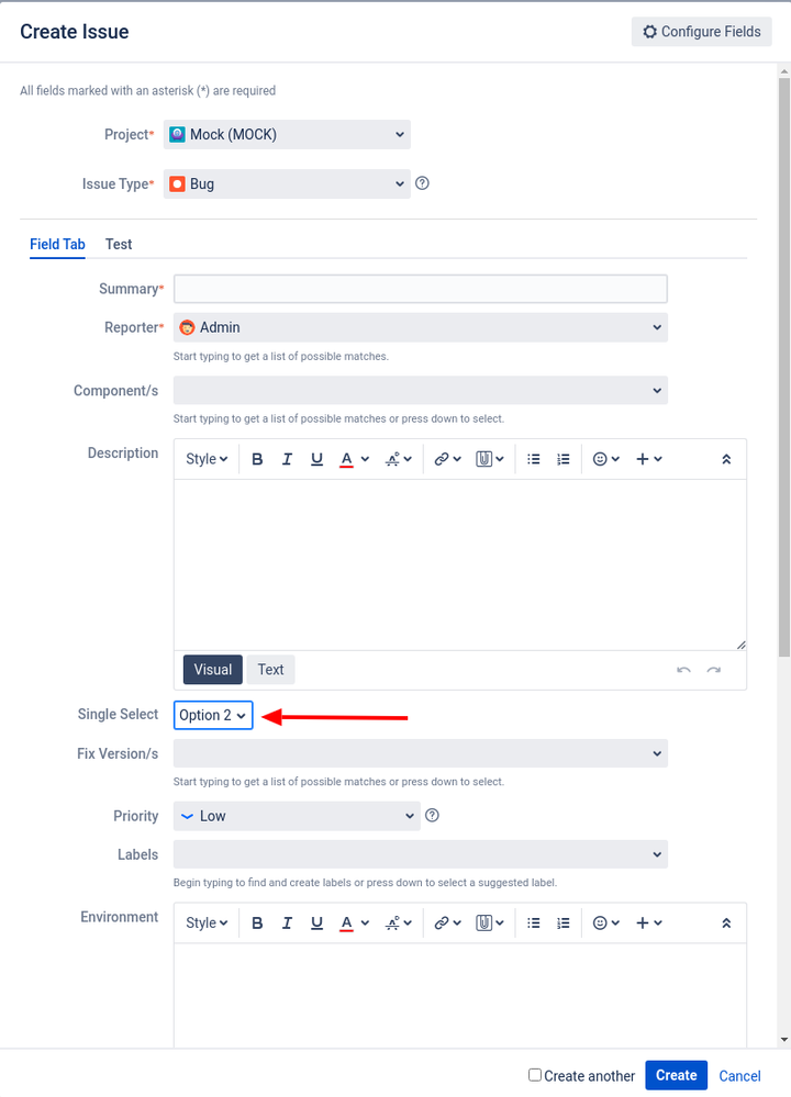

In this test case, the Single Select List "Single Select" is added to the first tab. If either Option 1 or Option 2 is selected from the Single Select List, the text field, i.e. Sample Text Field which is set on the 2nd tab will update accordingly.
I have run this test with Jira 9.6.0 and ScriptRunner version 8.4.0.
Below are a couple of test screenshots for your reference:-
1) The Single Select List is added to the first tab, i.e. Field Tab as shown in the screenshot below:-
2) When Option 1 is selected from the Single Select List on the first tab as shown below:-
3) As expected the text field Sample Text Field is updated to "Option 1 Selected" on the second tab as shown below:-
4) When Option 2 is selected from the Single Select List on the first tab as shown below:-
