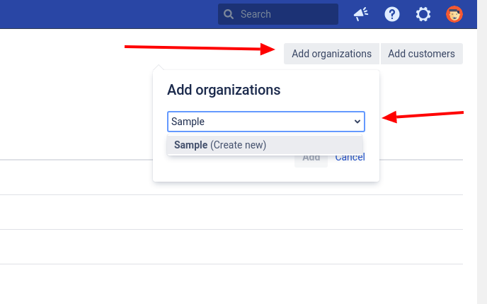

Or are you referring to the Add Organization field, i.e. as shown below:-
If it is the latter, the Behaviour is not usable.

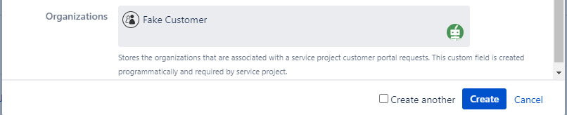

I'm sorry if my explanation seems lacking. what i'm trying to do is to set a default organization in the form when creating an issue.
Here's what i get when opening the create screen:
And here's what i want to have to be set by default.
What i tried to do was just to set the fields value using setfieldvalue i will leave what i tried:
