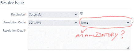

Customfield = ResolutionCode = Parent + Child

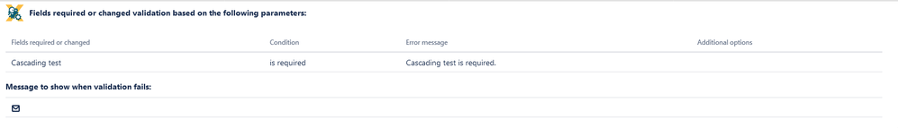

As Pramodh mentioned, you can achieve this with our plugin Jira Workflow Toolbox, using our Fields Required or Changed validator. You would just have to follow this steps:
With this configuration, both options will be mandatory. In the screenshot below you can see how the validator would look like:
Besides, with this validator you can validate as many fields as you need, and wether they:

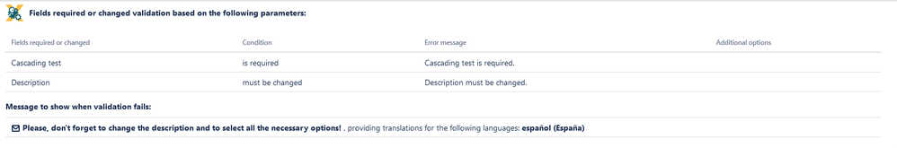

Regarding the error messages, you can add translations so all the users or customers are able to understand what they have to do in order to execute the transition.
Below you can check another example of this validator.

Hi Sergio, Yes thanks used Validation off Transition with some validation scripting.
