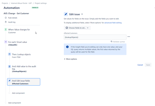

Here's a piece of my automation. I'm Branching through each ID value contained within the Multi-Select
Then attempting to set the values obtained in {{lookupObjects}} to the Insight Custom field

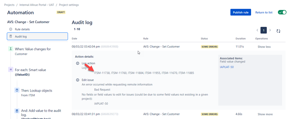

My attempts are either giving me an error like I can't set this value. I'm assuming I need something like {{lookupObjects.label}} but I can't find what syntax it is. You can see from logging {{lookupObjects}} that I'm getting the desired list of Insight objects I'd like to use.

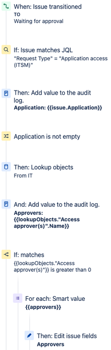

You are correct, you need to use the dot (.) notation to get to the actual value you want populate your field with. Here is an example of an automation I use to get approvers for different applications
Here is the documentation for Insight smart values.
