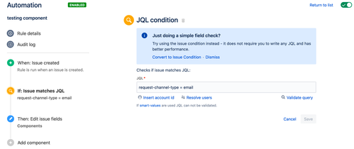

Per your description, I understand that you would like to set a single component when an issue is created through E-mail in your Jira site. Is that correct?
You can do it by using Automation rules. These would be the steps:
The rule above will automatically add the component you need to all issues created through e-mail.
Let us know if you have any questions.
