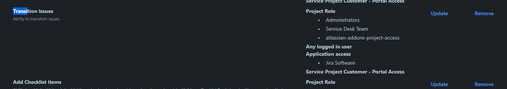

Grant "Transition Issues" permission in this Service Management project to "Jira Software".
Problem:

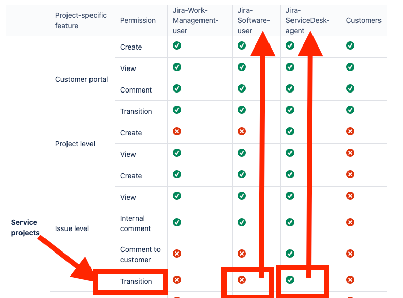

When doing so, SL3 still can't move the issues. I believe that the overview presented in this link is not only the default config but a configuration that cannot be overridden by changing permissions.

Image showing how this specific Transition is set:

That is correct. As shown on the table in the link you found, a user must have a Jira Service Desk Agent license in order to be able to Transition issues in a Service Management project.
