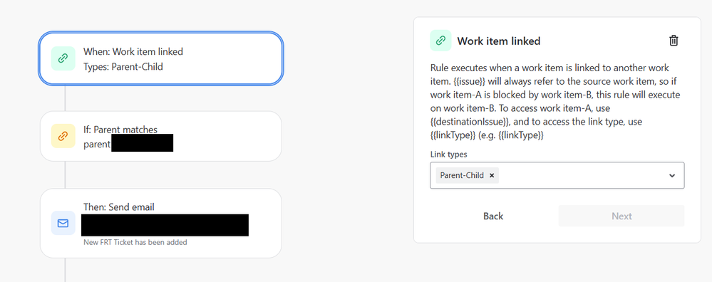

I am trying to setup an automation rule when a child issue has been added or linked to a Particular Parent it should send out an email to certain people.
I will explain with example:
I have an initiative which tracks a certain activity. This Initiative is linked with several epics that track the changes we are making. The automation rule I want to set up should be such that when a new epic is linked or added to that initiative it should trigger an email to selected people
I did try to setup the automation rule but I am sure I missing something in the trigger itself
Please let me know the best possible way to implement this

Hi @srikanth_rao
How are you "linking" the work items?
If you are using the built-in parent / child relationships with the Parent field, please use that instead for the trigger:
  • trigger: Field Value Changed, selecting Parent, possibly selecting "value added" for the change type
  • condition to check the Parent value
  • action: send email
Bill
srikanth_rao May 13, 2025
Thank you @Bill Sheboy ! The solution you provided helped me get the required setup in place.
