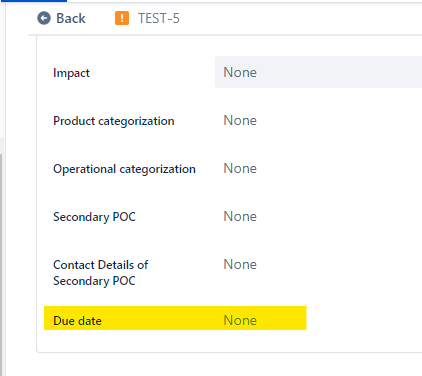

I think I need to firstly somehow get the Due date field populated with a date for each of the given Time Goals 18h, 45h, 90h or 135h
Once I can get a static Due date populated, I think I could then work on the Due date getting refreshed depending on the status of the ticket.

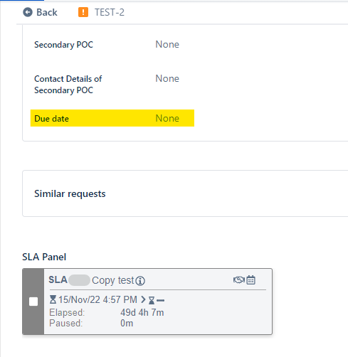

Currently when I run a report for our customer the Due date is empty, the customer has asked about the Due date - I could manually populate the date but that doesn't work for me.
I've downloaded the Time to SLA attempted to configure it - unfortunately a lot of the configurations and drop down possibilities went over my head, having said that Time to SLA now displays this on the ticket.
 Ideally as mentioned above the Due Date field would be populated so it is displayed in the export report we use.

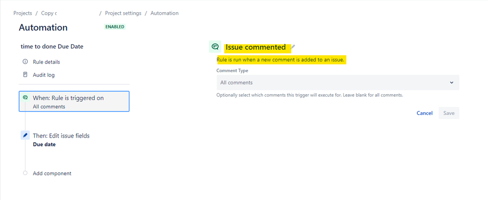

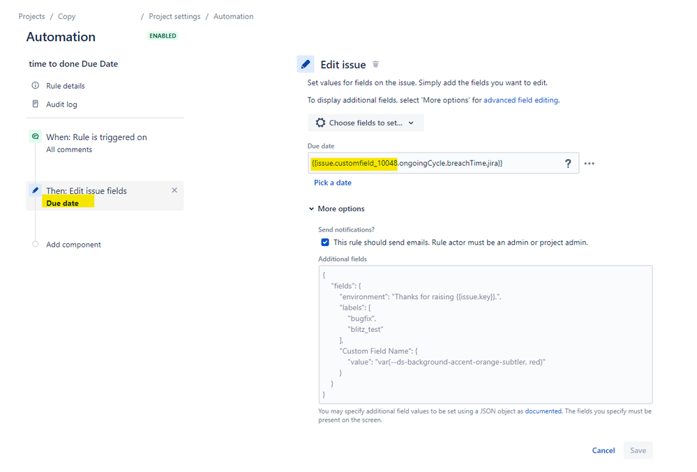

Prior to raising this post,  I attempted to Automate the Due Date with the following from Comments expecting the Due date to be populated. it never happened.
the issue.customfield_10048 was found by by entering the ticket number in the <issuekey> searching on the SLA name and then pasting the customfield number. finding custom field.png
Which hasn't appeared to have  worked.

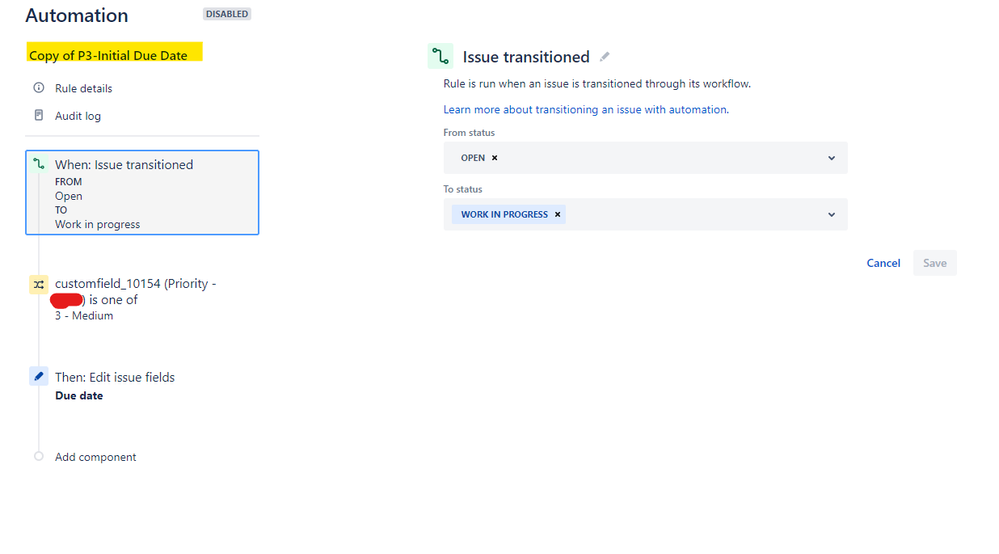

I've since found an Automation in another project that a previous manager set up but never documented how it was achieved. The Audit logs only show it has worked triggered twice. in 3 years
With that Project open to Automation on one screen and my Ttest Project open on another screen in an attempt to reproduce the configurations one by one I'm unable to populat a field.
The Issue Transitioned appears easy to follow
When I get to the issue fields condition  the working automation displays  customfield_10154 (Priority -G.....
This isn't an option from the drop down, I can't select the text copy and paste that text into my test project and amend., I'm unable to see the full text
I also noticed that the drop down only shows 50 of 134 - is it possible to display the remaining options

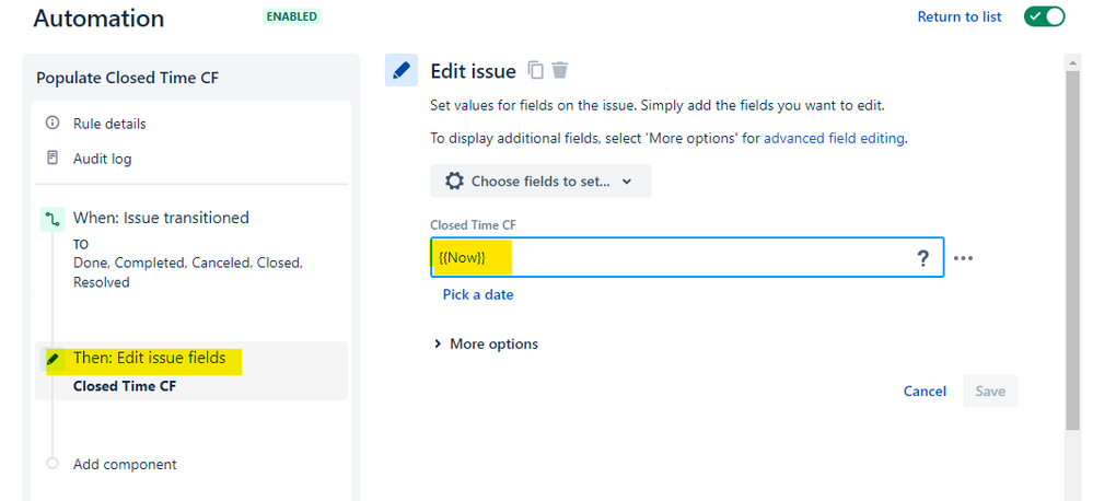

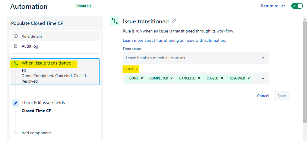

a. I created a Custom field called Closed Time CF  which is a date / time field  in the ticket type of  the project I wanted. (CF= Custom field so I and others know it is a Custom field at a later date).
b. I then created an Automation so when a ticket goes to a status  of Done, Completed, Cancelled, Closed, Resolved the Automation will update Closed Time CF with the Now date time - this might help with resolution date you mentioned above.
Please see the attached screenshots of the Automation
I hope this helps

Hi @Dave , first of all thank you very much for answering, I was doing some more research yesterday and what I did was that the due date field could be updated automatically with the resolution date assigned by the SLA previously configured.
The post that I found and helped me is: https://community.atlassian.com/t5/Jira-Service-Management/Time-to-resolution-copy-to-Due-date-minus-one-day/qaq-p/2286780
Where when updating the date assign the following code : {{issue.Time to resolution.ongoingCycle.breachTime.jira}}
The execution I have it configured to be done every day.
Diego.
