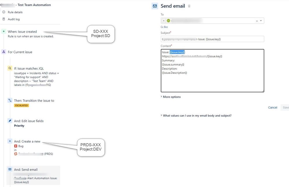

I've set up an automation where when an issue is created in (SD-XXX) Jira (matching the JQL condition) it will create a new issue (as a bug) in another project DEV (PRDS-XXX) for escalation to the developer then it will trigger an email to the dev group email.
The automation is working but my problem is when it triggers the email it's showing the SD-XXX {{issue.key}} but not the project (PRDS-XXX).
What smart value should I use in this case to show the DEV PRDS-XXX issue key instead, in the triggered email?

The automation below

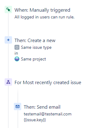

Now if you really need this through the automation you can do it as follows (cause I don't think you can get the smart value without some additional queries):
You add a Branch/Related issues component and send the email from there.
Your Brand rule would look similar to this: (you can use all created issues or most recently created)

Earl Kabiling September 24, 2020
ahh that makes sense, thanks  @Dirk Ronsmans both of the solutions you have recommended works :)
