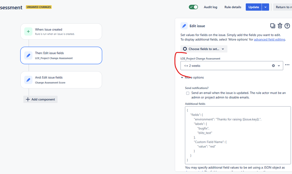

×I am trying to set smart values for a select list, single choice field. However, when I add it to an edit action I do not get the blank field to add in the custom code, I am only getting the 3 options setup for the select list. I did a test adding the filed from the request type and that allowed me to add the code.

Thanks for the reply! I'm not trying to add new fields, I am trying to assign values to the choice field options so I can calculate a total at the end (for a risk assessment). For whatever reason, when I use a field I used in custom fields it only lets me select the custom choice options but when I created the field right from the service request, it does. Not sure if it technically maters where I create the field.

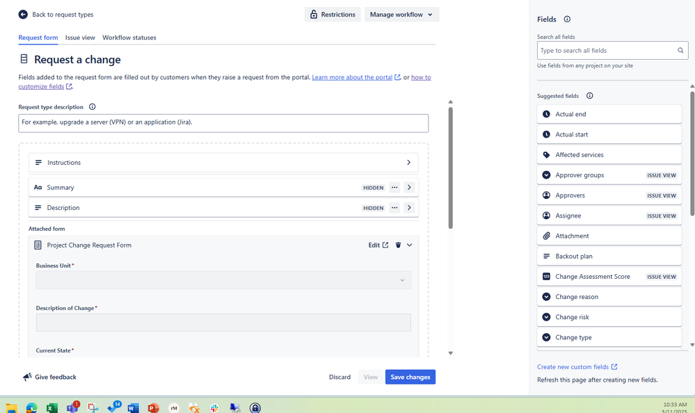

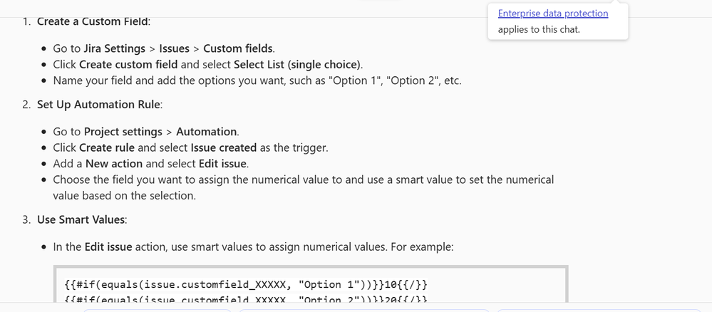

The screen shot above is the automation, and below is the request form. I haven't done anything besides try to assign the values. I was also mistaken, the field I was able to assign values to before was just a number select field. According to my research (shown below) I should be able to assign values to the custom options fora select list (single choice)

P.S AI isn't smart on JIra, this comes from experience. It will even combine options to find solutions based on on-prem and cloud options combined and that will never work, as this is impossible.
Best practice, don't use AI for Jira Automation
