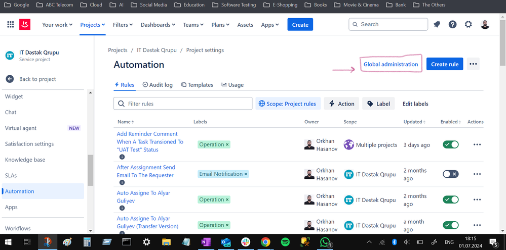

Hello! I followed your automation rules for my setup but I can't seem to get the service project to update. Any tips?
Hello @Noel Ransom , Is that global automation? If there are two projects, you must set them up as global automation, and of course, multiple projects. Maybe this was the problem. But you must share the audit log, as Trudy Claspill said.
Thanks to you both! I found the JIRA global automation menu, I think that was my issue, I built it only under one project. I'll look at logs there if it still doesn't work and post here.
You are welcome ! Without seeing the logs, I thought maybe you missed setting up the multiple projects. I made mistakes a few times. If you set multiple projects and select them. I think you must analyze the audit logs.
