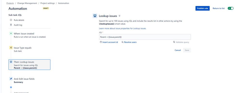

Hi @Peter Grainger - You could try something like this with automation:
Parent = {{issue.parent}}
{{issue.parent}}-{{lookupIssues.size}}

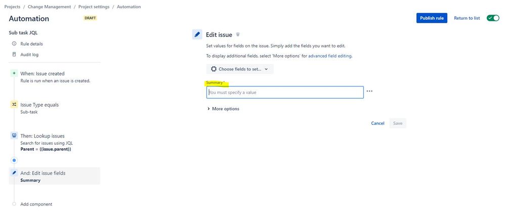

Hi @Mark Segall , Thanks for the reply. What is the result of creating the above mentioned automation? When I try to create the 2nd action it does not give me the option to enter the JQL query, only a description for the issue, am I missing something? Thanks, Peter
That's not a query. These are smart values which are known variables that you can provide Jira.
Breaking this down:
Putting it all together, let's say that you've created your first sub-task on issue key CM-13
The second would make CM-13-2 and so on.
