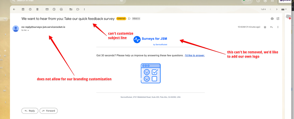

Cons: When the survey emails are sent out, they cannot be branded with our company logos, and the email customization is very limited. Customers would have no idea where it came from and which ticket it comes from. I reached out to support about this, and they provided this feature request ticket \ when I reached out to their support team about the issue. This was a big showstopper for us, and I've attached what the email to the customer looks like, which has limited customization.

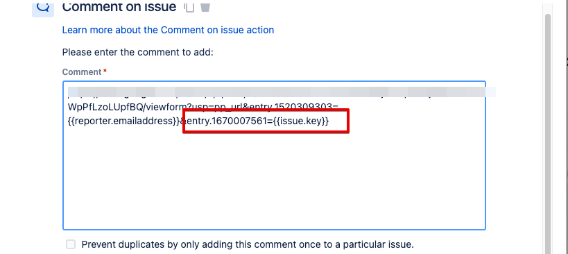

For now, I am going to go with Google Forms (free solution) as it seems we can do everything we want via automation and then posting the comment with a link to the survey when the ticket is closed.
Step 1: Schedule the JQL to run every day. (still need to create a custom field caled SurveySent to track ticket on which the survey is sent)
project = "AS" AND resolutiondate < -2d AND project = "AS" AND status was not in (reopened) AND resolutiondate >= 2023-06-01 OR key = AS-13713
Step 2: Post an automated comment with a link to the Google Form. There is a feature in Google Forms that allows you to pre-fill certain fields, so I've set it up to pre-fill the ticket key and the reporter's email address.
Good day, and this is Danny from ServiceRocket.
We would like to thank you for exploring our application, and appreciate the kind feedback on the functionalities. At the moment, it is indeed not possible to customize the Email template, but we would love to understand more about your use-cases shall you be open for an interview. To ease the communication, we have created a support ticket available via the link below:
We may discuss further there, and shall you have further questions, feel free to let us know.
