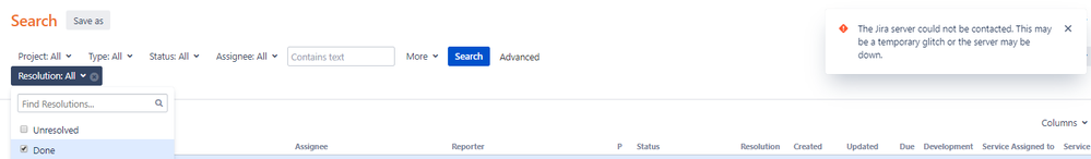

Jira has been recently upgraded from 7.11 to 8.1.0 are we are unable to go to any higher versions than this. Now when trying to do a 'basic' search in 'Search for Issues' and then a field is selected from the 'more' button the following error appears.
"The Jira server could not be contacted. This may be a temporary glitch or the server may be down".
I have tried different browsers / incognito mode etc / cleared browser cache but issue remains
An advanced search for the same criteria is successful.
I would like some help on how to resolve this. I have had a look through the log but cant single anything out that might be causing it.

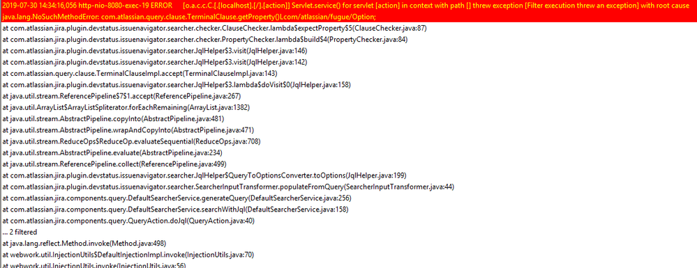

Error being reported in the atlassian-jira-log file
http-nio-8080-exec-14 ERROR [o.a.c.c.C.[.[localhost].[/].[action]] Servlet.service() for servlet [action] in context with path [] threw exception [Filter execution threw an exception] with root cause
java.lang.NoSuchMethodError: com.atlassian.query.clause.TerminalClause.getProperty()Lcom/atlassian/fugue/Option;

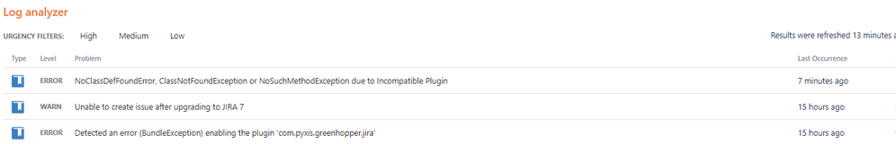

Checked log analyzer and still reporting some errors.
