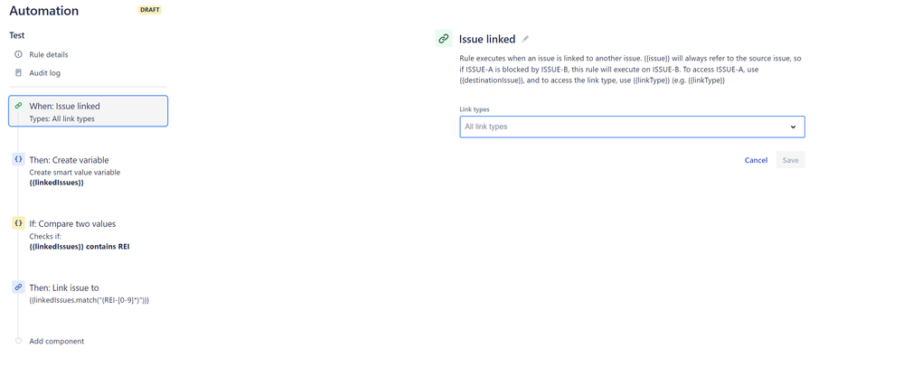

The Issue Linked trigger is a special trigger.
When an issue link is created there are two issues involved. Most triggers are activated by a change on a single issue.
So the Issue Linked trigger will be triggered for only one of the issues, but will let you reference both of the issues. The issue that is the one that triggers the rule is referenced by the {{issue}} object, while the other issue in the link pair is referenced with the {{destinationIssue}} object.
The triggering issue for the rule is not based on which issue you are viewing when you create the link.
The triggering issue will always be the one that appears under the Outward Description for the link type in the Linked Issues section.
If issue A "is blocked by" issue B, then issue B will be the triggering issue for the rule
If you look at the details of issue A, under the Linked Issues section you would see the heading "is blocked by" and issue B would appear under that heading.
So, if you are in issue A and you create a "is blocked by" link to issue B, it is the change in issue B that causes the rule to be triggered.
Within the execution of that rule, issue B would be accessed using {{issue}} and issue A would be accessed using {{destinationIssue}}. When you are adding steps to the rule, you must keep in mind which issue is the triggering issue and which is the destination issue.

Ahmed Aftab
January 8, 2024
Hi @Ravi Sagar _Sparxsys_
I am facing a similar problem.
The linked issue trigger only works when issue link "Blocks" is used. For cases when the issue is linked as "is blocked by" the automation rules don't trigger at all.
It is mentioned in the linked issue trigger that rule will always refer to the source issue. I am unable to set it for destination issue.
Your help in this matter is highly appreciated!Screenshot 2024-01-08 132832.png
