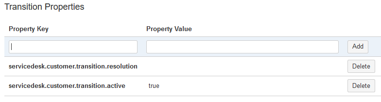

I have recieved feedback from two customers (different projects, same workflow, same permissions) that they are not able to use the transition "back to support" from status "waiting for customer" to "waiting for support".
As for what I know, other customers are able to use this transition.
What I have already checked:
  • workflow is activated for the projects
  • transition is activated for customer portal
  • in the application the transition is executable by our agents
  • permission "transition issues" is granted to "Service Desk Customer - Portal Access"
So I am not sure where to find the problem... Maybe someone else finds it.

Tomáš Vrabec
November 14, 2019
Founded! Atlassian solved this within this issue https://jira.atlassian.com/browse/JSDSERVER-6402stuck for few hours with them too. Just upgrade the JSD.

Martin Müller April 9, 2019
Autor ändern
Die Fähigkeit, den Autor beim Erstellen oder Bearbeiten eines Vorgangs ändern zu können.   -> Service desk-kunde - portalzugriff
This is needed (Change Author) to get the transition working in the customer portal.
