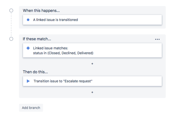

August 20, 2019
hi @Swarna Radha ,
Sounds a bit complicated, why don't you use automation and configure the automated transition of the parent ticket once all linked tickets reached a "Done" state.
Let me know if this works for you.
Cheers,
Radu
Swarna Radha
August 20, 2019
I have used automation rule before scripting, it does not check if all linked issues are closed. If One linked issue is closed, issue is transitioned to Open. But all the remaining linked issues are still opened
