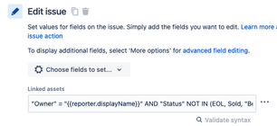

When you set an asset field to a value you have to use AQL in order to get the object. Here is an example of an automation that sets the reporter's asset when they submit a request:
In your case if the object is always the same for the specific request type then this AQL should do the trick for you:
"key" = "<object key>" i.e. "key" = "IT-123"
