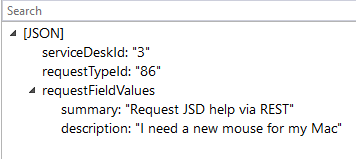

Endpoint:
rest/servicedeskapi/request
Json body:
What could be reason behind this?
