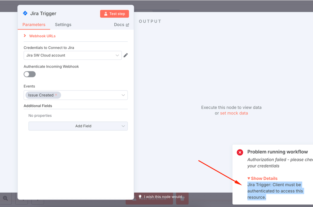

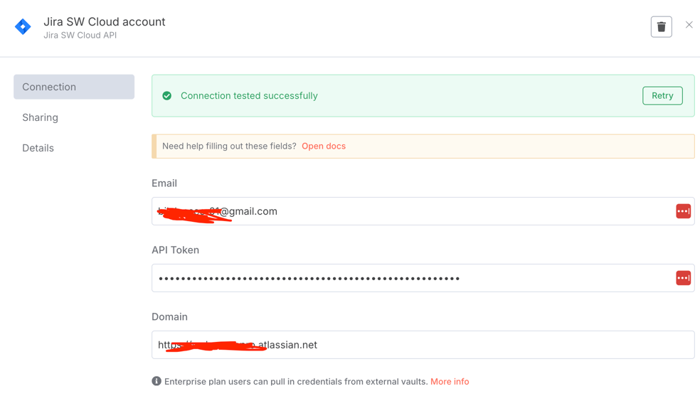

Any one has any idea on how to connect JIRA with N8N. I have followed this documentation https://docs.n8n.io/integrations/builtin/credentials/jira/ and successfully created credentials, check screenshot below:
But when I add a Trigger node for "Issue Created" I am getting this error "Jira Trigger: Client must be authenticated to access this resource."
Here is the screenshot:
Any help to resolve the issue is appreciated.

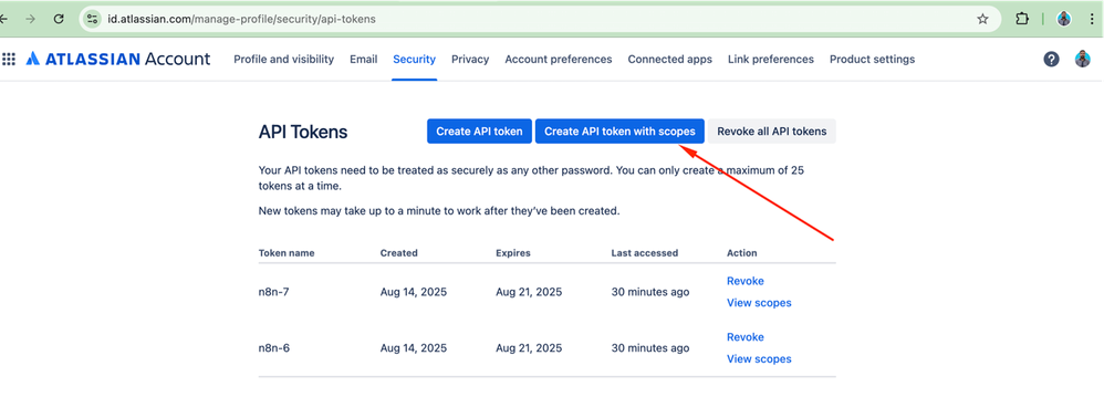

Create a new aPI token without a scope, does this work.

Looks like API Token without a scope is working. How stupid I am. I didn't bother to check API without scope.
Note: Before creating API Without scope I used "Permission Helper" from Project settings > Access > Project Permissions > Permission Helper in order to test the permissions. And I did have necessary permissions to perform the action.
But it's only working without API Scope

You will need to find out what scopes are required by N*N, actions it will do to create a token with scope and select the correct ones.
