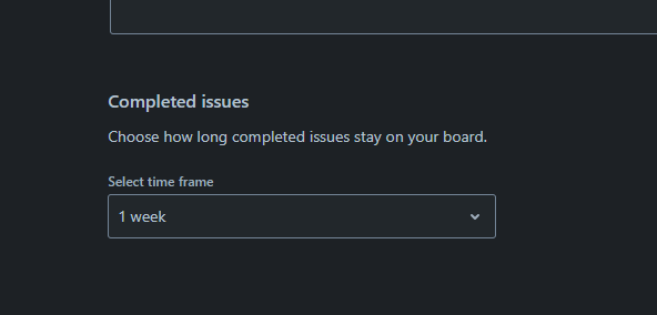

I have setup my board to hide done issues after 1week, but when I click in view older issues it shows error.
See the below screenshot:
Does hiding issues delete them completely?
Settings screenshot:
