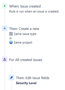

If there's some default security level defined, you probably won't be able to set any other during the issue create action. But I think you can create automation rule with 2 steps
  1. first one will create the issue (with the default security level)
  2. the second one will update security level for all created issues
