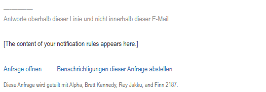

I would like to add an unsubscribe link to an e-mail sent from an automation, just like the unsubscribe link from the customer notification e-mails.
(The right one, which says "Benachrichtigungen dieser Anfrage abstellen".)
The unsubscribe link from the customer notification e-mail looks like this in the template:
<a class="jsd-unsubscribe-link" href="${request.disable.notifications.url}">Benachrichtigungen dieser Anfrage abstellen</a>

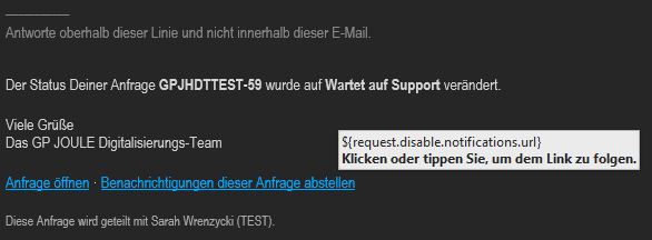

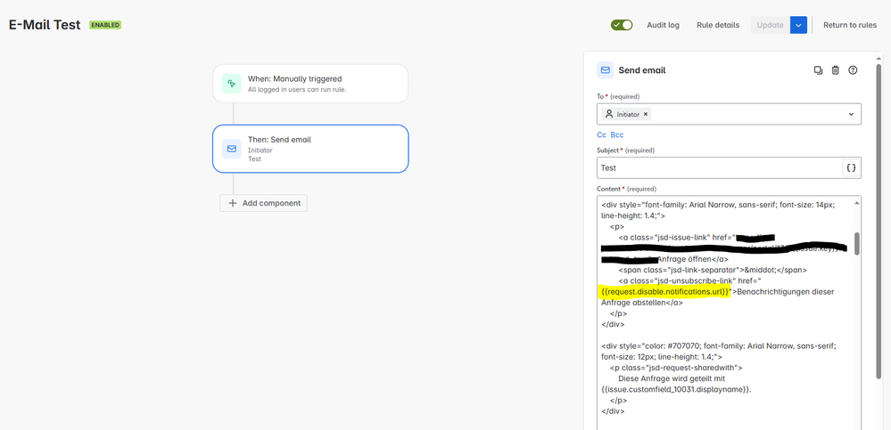

However, the link does not work in an e-mail sent from an automation, and there seems to be no similar smart value like {{request.disable.notifications.url}} to achieve this.
The e-mail displays the links, however, it is non-clickable.

thanks for your reply! Yes, the unsubscribe link should be a clickable link in the e-mail I'm sending to my customers. I also tried using {{request.disable.notifications.url}} as a smart value, but the link just came back blank in the e-mail.

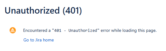

I copied the unsubscribe link from the source code of an e-mail send through standard customer notifications. It seems to have the following format:
[site]/servicedesk/customer/portal/[number]/[issue key]/unsubscribe?[token]
I think, the issue is with the token, because when I want to re-use the link for another issue key, I just get a 401 (Unauthorized).
