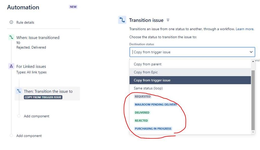

I sort of had that in place but I can see the transitions from the main issue.

I am creating the automation in the Procurement project which is the linked issue.
The transitions in the first step are from the procurement workflow, but the 'transition the issue' is still only showing the procurement status, I thought if I said 'For Linked Issues' it would pull in the status from the main issue.

Ah okay, so what you will need to do is go to the global automation section (Settings > System > Global automation) and create your rule here, as otherwise it won't pull through the statuses of the linked project.
Under 'Rule Details' you will need to select 'multiple projects' from the Scope dropdown, and select both the Procurement project as well as the other project which issues will be linked to. This should then pull through the combined list of statuses of the workflows in both projects. Once the rule is saved, this will then appear in both projects under the project's automation rules section, as it is scoped to both projects
Callum Carlile _Automation Consultants_
September 8, 2022
Based on your screenshot, I would also recommend limiting the branch to just the single branch type that you have configured in your automation rule which triggers the link in the first place, as well as maybe add a 'project = main issue project' condition within the branch, just to ensure that no other issues linked to the Procurement project issues are actioned by the rule

It's a linked issue and no matter what I try I can't see the transitions from the main issue.
