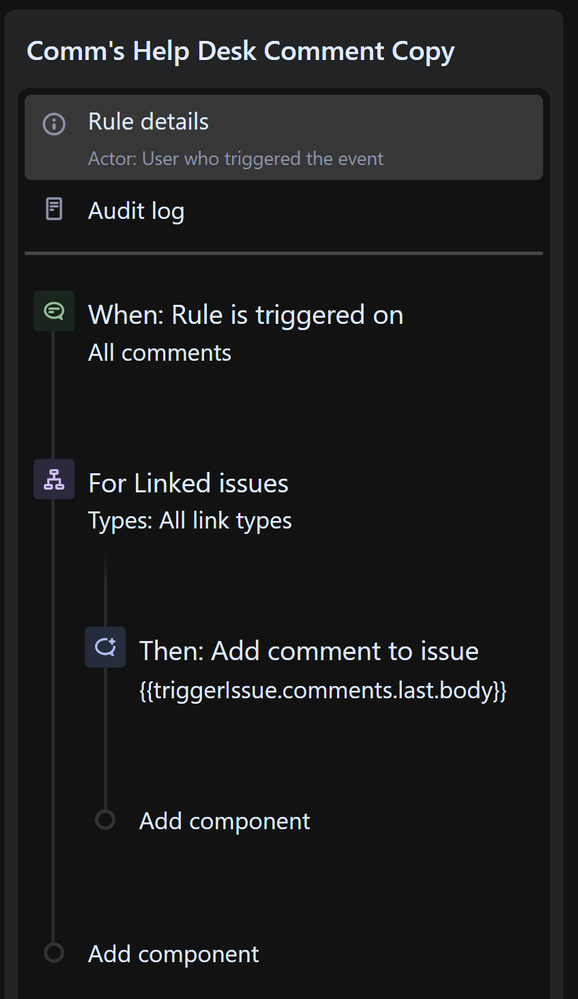

So to make this work, you have to utilize issue links and automation branching. This is the rule that I have setup and it works. We have this setup in global automation since it needs to work both ways for two different projects.
When you clone an issue, have it add a link to both issues. That is what the automation rule above will use to move a comment from A to B.
Keep in mind that we are not cloning an issue and then closing it. In our particular use case will have back and forth communications on these issues. So our automation only needs to move the last comment.
Also note we have set the actor of the rule to "User who triggered the event". So when a comment is posted, it will be posted as the person who made the comment. Otherwise you will have a lot of comments from the automation service and sometimes knowing who made a comment is very important.
Hopefully that helps move you in the direction you need. If you have more questions, just let us know!

Hi David, thanks for your response, it was a great help. I just had to move the automation rule to the global level to get comments synced across both projects.
