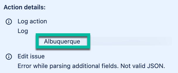

Thank you! I think I'm close. I put a 'log' step in there to verify it's pulling the Attribute from the Object, and it is. But then I get a parsing error. First image is from the automation log - shows "Albuquerque" which is the Unit Name ... and this is what is output to the log: {{lookupObjects.Organization (Jira)}}

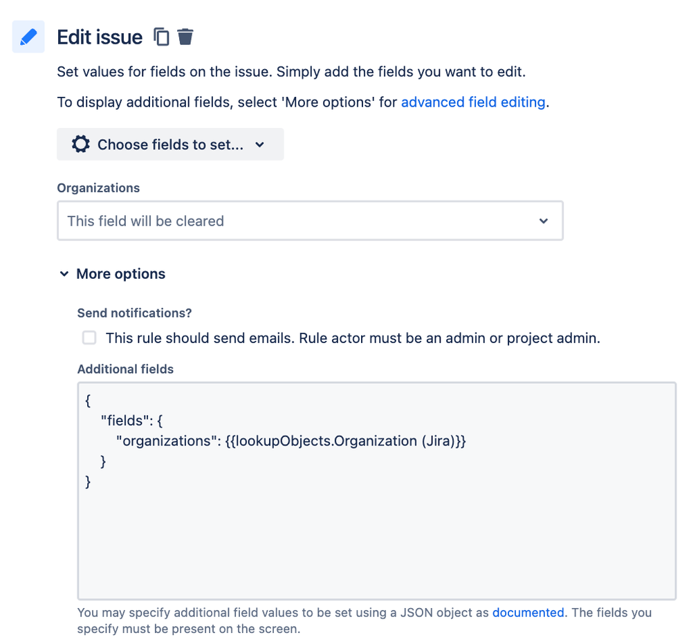

Then I try to edit the issue with the second image below, which is giving the parsing error. Not sure what I'm doing wrong.
Your JSON that you are using is missing "" around the smart value, try this:
"fields": {
"organizations": {{lookupObjects.Organization (Jira)}}"

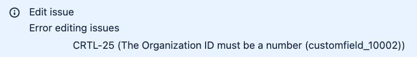

Okay, getting closer. It doesn't like the text value that's in that attribute. I wants a numeric. Do I have to change the data type for the field or is there some magic I can do?
And this is what the script looks like right now - I had to surround it in brackets as it is expecting an array:
"fields": {
"Organizations": ["{{lookupObjects.Organization (Jira)}}"]
Okay, so you need to map your Asset org to the number that JSM is using for the Organization field (much similar to user picker fields that takes the user's Atlassian ID). If you go to Customers in your JSM project and click on an org you will see that the URL ends with at number (.../jira/servicedesk/projects/SIT/organization/2), that is what the field is expecting. So you could add that number as an attribute on your organization in Assets and then get it using object reference like this:
{{lookupObjects.Organization (Jira).(attribute name)}}
Thank you!! I’m cooking…
Because Jira Automation was expecting a number, I think the double quotes were screwing things up (meaning, I think I needed to convert the text back to integer somehow), but the workaround for that was creating an attribute name with no spaces. I’m also going to change the value of the attribute from the name of the Unit to the internal Org ID as you noted. Thanks for the quick help and guidance.

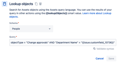

It should be pretty straight forward, all you have do is add the lookup object component and set it up to search your object schema and then use the selected unit to find the object. Then you can use {{lookupObjects.Organization}} to set Organization.
Something like this:
In this case I am looking up departments based on what was selected on the form and then get attributes from that object to set the approvers.
