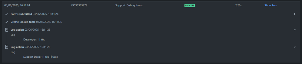

It returns:
Log action 03/06/2025, 14:17:17
Developer: 1 | |
However I'm unable to figure out why `{{issue.forms.1fb00898-1f81-44d0-9617-91eecb5db6b3.last.isDeveloper}} returns the 1 (for Yes) and 2 (for No) but neither the radio lookup table or if equals works...
Can someone tell me what I'm doing wrong?

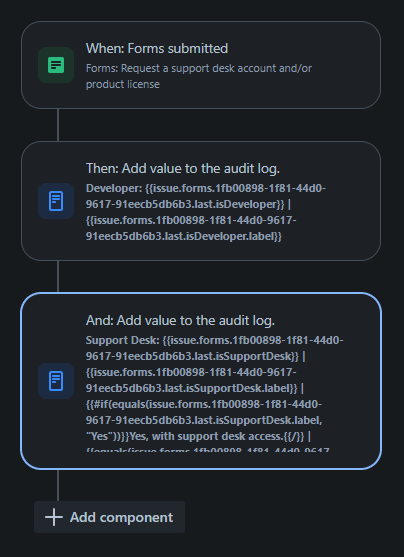

Thank you for the reply:
Using `.label` got me a little further but the check for equals still doesn't work correctly.
Support Desk: {{issue.forms.1fb00898-1f81-44d0-9617-91eecb5db6b3.last.isSupportDesk}} | {{issue.forms.1fb00898-1f81-44d0-9617-91eecb5db6b3.last.isSupportDesk.label}} | {{#if(equals(issue.forms.1fb00898-1f81-44d0-9617-91eecb5db6b3.last.isSupportDesk.label, "Yes"))}}Yes, with support desk access.{{/}} | {{equals(issue.forms.1fb00898-1f81-44d0-9617-91eecb5db6b3.last.isSupportDesk.label, "Yes")}}
Perhaps, with this information, the use-case is a bit more clear. It feels like I'm missing something obvious...
Thanks again!

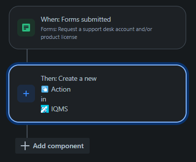

The component for creating the new ticket is directly after when the form is submitted.
I want to use the value in the 'Create a new' component. This is to dynamically include or exclude list items in the description field of the new ticket.
The automation is very simple.

The 'Actions' part of the description I'm trying to simulate by using the 'Log' component of the automation does not.
So far I've tried:
In these tests 'equals' always returns false.
The comments prior to this are simply to get the smart value to display using the Log component to prevent creating new tickets each time I test it but I can't seem to get it right.

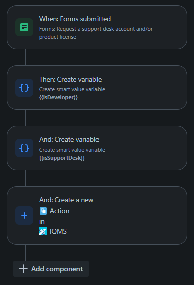

Great tip. Using the 'Create variable' seems to work weirdly enough.
Then, in the smart field:
{{issue.forms.1fb00898-1f81-44d0-9617-91eecb5db6b3.last.isDeveloper.label}}
And finally using:
{{#if(equals(isDeveloper, "Yes"))}}* Create a license.{{/}}
I wouldn't have figured this out using the documentation, and it's counterintuitive but it works.
Thank you for the help.

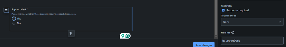

Make sure the Field Key is set
Based on the form submission you can use a smart value condition.
{{issue.forms.1fb00898-1f81-44d0-9617-91eecb5db6b3.last.isDeveloper}} equals 1
