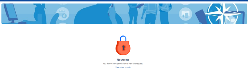

They have received a Jira email with a URL to 'View request' that requires approval -
When the use clicks on View Request, they get the below page -

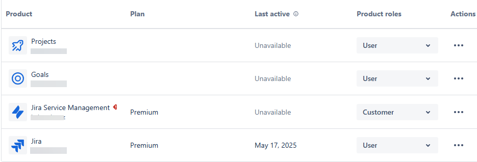

The user has Service Desk Customer & Team assigned to them within the Project in JSM.
The user also has a Jira Premium license assigned to them under Admin > Users.

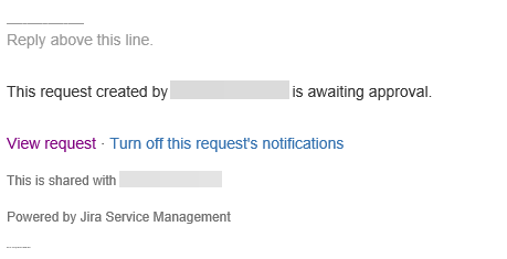

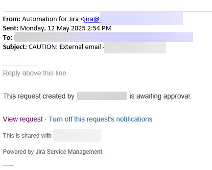

The user got the email from -
They then clicked on 'View Request' link.

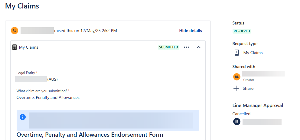

This link should have taken them to the ticket that a user has logged in our staff portal to approve/check (example below) -

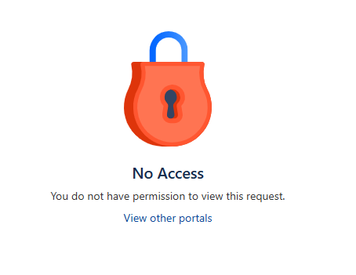

Instead, the user gets the 'No access' screen with the padlock icon -
Below is what the user is assigned too -

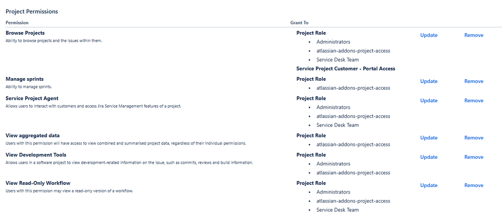

Hi @Joshua Stokes ,
A couple of things come to mind if the user is not able to view.
  1. Does the permission scheme include customer for the browse issue permission?
  2. Is there any issue security set on the issue?
Take a look at those areas if there's any issues there. Hope this helps

Hello @Benjamin
Would the Browse Issue Permission be 'Browse Projects' as there is not one for 'Browse Issue'
The above is under our JSM Permission Scheme for this particular project.
Also, where would be the best place to navigate too, too find any issue securities set?
Thank you!
Benjamin
May 19, 2025
All looks okay from the permission scheme.
Let's take a step back. This user is intended to be in a customer role?  If so, let's remove the Team role. The team role is intended more for agents.
