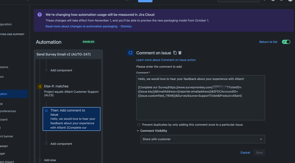

We are sending out support csat surveys on our jsm tickets once a ticket is closed. However we are running into issues with low response rates on the surveys.
We would like to send reminders out 3x, but also stop sending out if someone clicks a link to fill out the surveys..
Is it possible to design this link such that it would update a custom field on the ticket if the survey link is clicked so we would stop sending reminders
I am sure we might be able to do something using survey monkey's API, but that would be a last resort since that involves asking a dev for help
