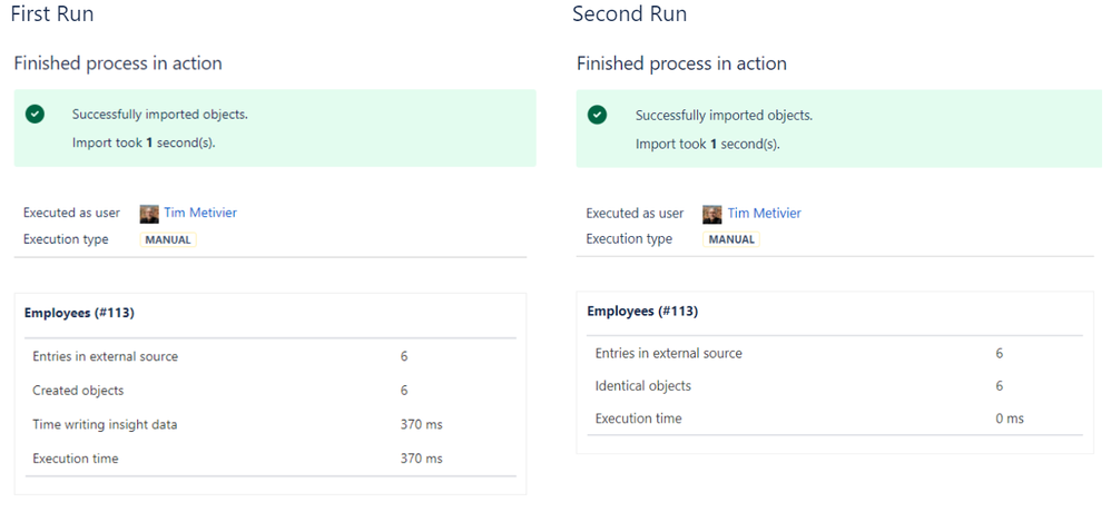

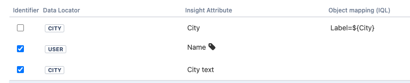

Using the following configurations and importing the employees.csv, I can execute the import configuration a second time with the exact same data and file.
These screen shots show the first and the second imports, and as expected, there are 6 identical objects on the second import.

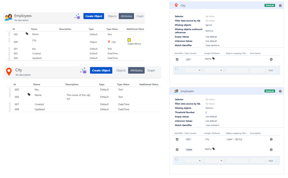

In this scenario the City object type is introduced, and the Employees City attribute is changed to object type City.

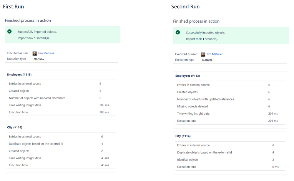

Now, after importing the objects initially, a second run with the exact same data and file causes all objects to be considered "missing". They are deleted and new issues are created.
This creates a particular problem when using the Update Missing Objects approach as all objects are considered missing, new objects created, and the existing objects have the configured field updated.
