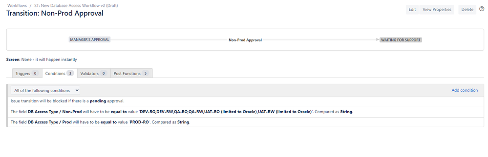

Hello. I need help with figuring out why this transition of Non-Prod Approval is not working. It worked once before in another workflow that was replaced but now does not work in the new transition. Any idea of what I missing.
For the transition condition, the issue must fulfill all of the conditions criteria before one can execute the transition. You will need to check to see if the issue (ticket) passes on the criteria or not.
Hope this helps.

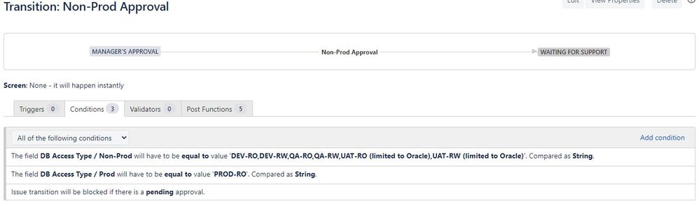

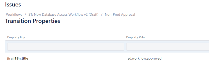

Hello Joseph. Thanks for the prompt response. I have reviewed the condition criteria and all lines up. I tried adding a new property but that did not help either.
So when you moves an issue, do you see the transition button or the transition in the dropdown list? If is there, what is the error thrown we you try to move the issue via that specific transition?
I don't understand why you try to add properties, that will not resolve your issues.

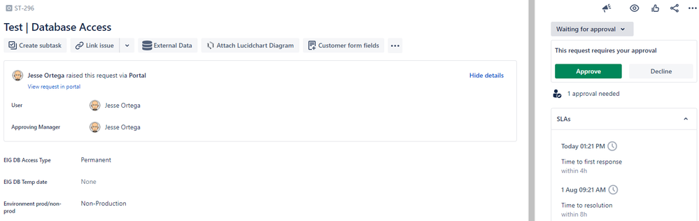

No when the issue is moved there is no transition button. It goes directly to the second approval.

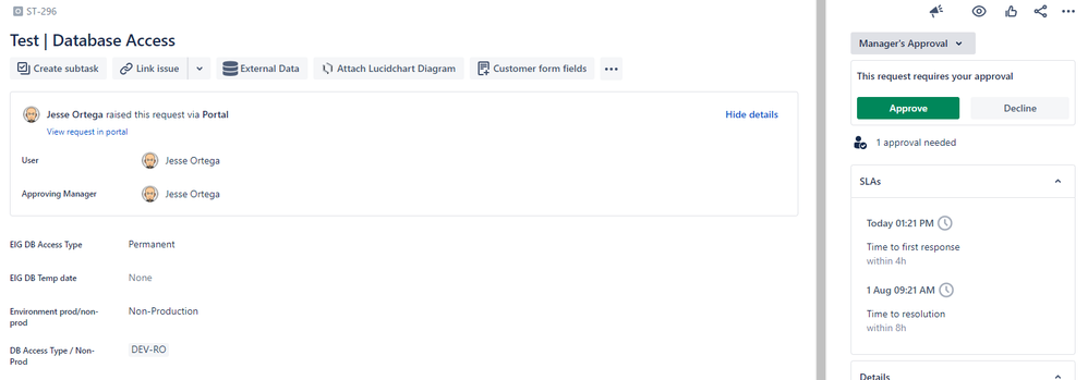

This is the ticket when first opened. Once the manager approval is completed, the issue should transition to "waiting for support".

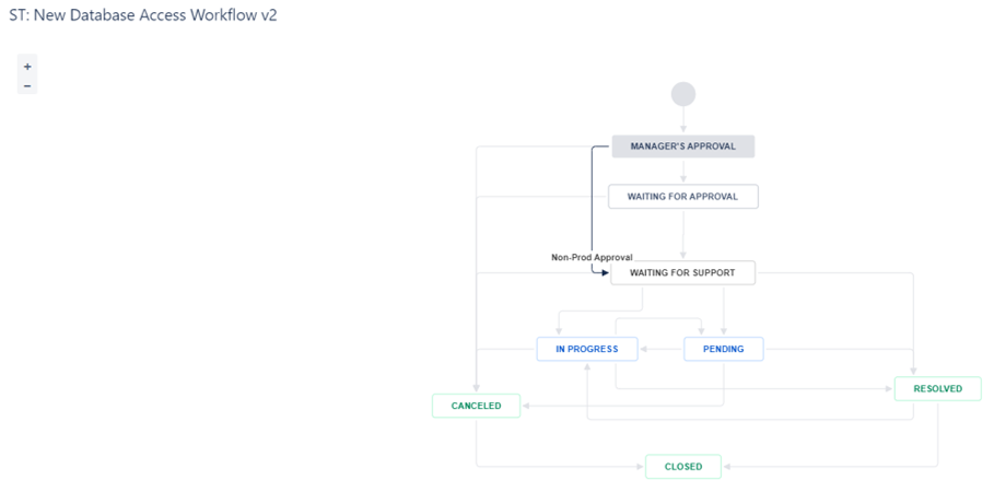

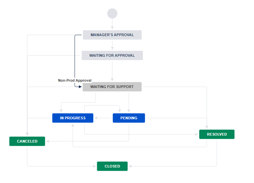

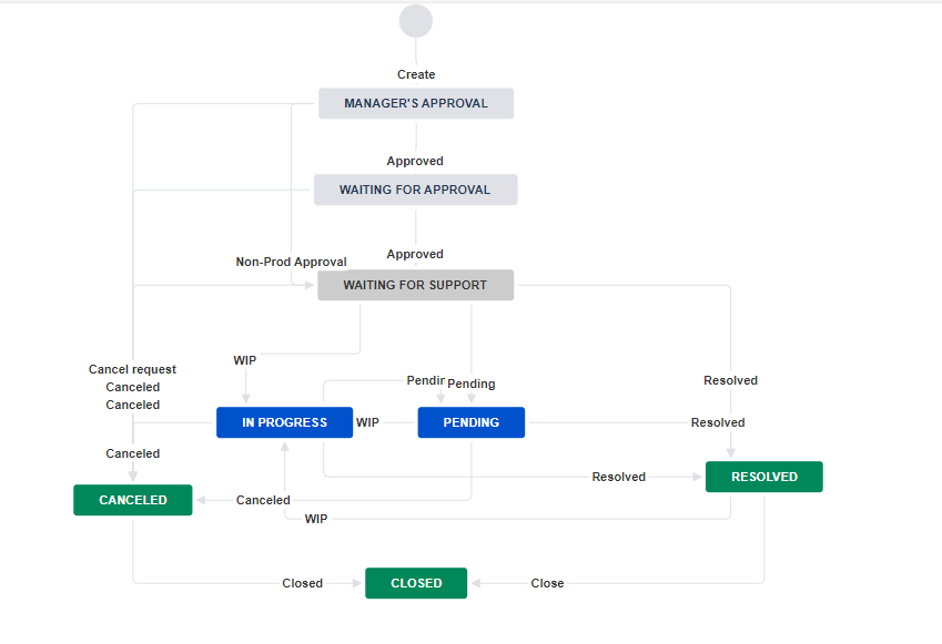

This is a screenshot of the workflow.
So the issue is that once approved (when issue at Manager's Approval), it is not going to "Waiting for Support" automatically? Or, it is not doing so?
I am a bit confused on what is the issue. Please clarify.
Best, Joseph
Yes, that is correct. Once manager approved, it is not going to "waiting for support".

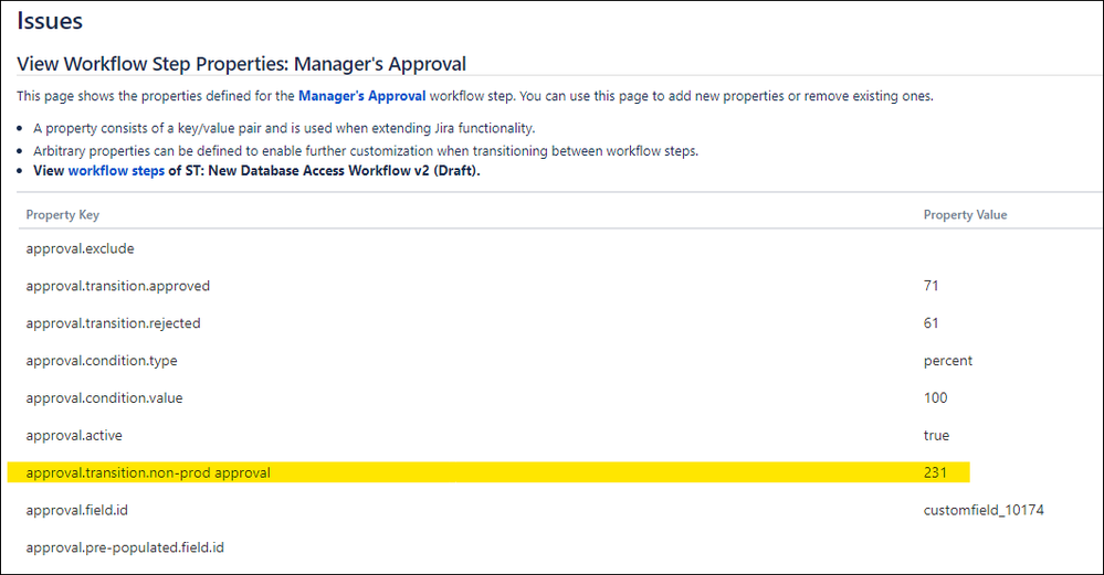

After looking at it further and testing on my end, here is what you need to do to fix the problem -
1) In the properties setting for your Manager Approval status, remove your manual entry of approval.transition.non-prod approval entry.

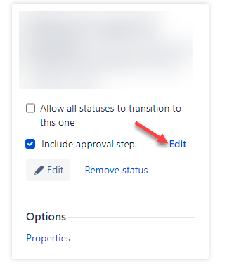

2) View your WF in the Diagram mode, click on "Manager Approval" status, access the EDIT option associated with "Include approval step.
3) In the Edit approval step pop-up screen, change your "Select transition if approved" dropdown option to "Non-prod approval" and save the change. (This will also automatically update the the Properties associated with the Manager Approval "approval.transition.approved" property key's property value to the transition ID for the "Non-prod approval" transition.
It will resolved your issue. The key is that Approval actions of Approved or Declined can only have one specific status to be automatic transition into based on the approval outcome.
Lastly, I also saw a transition between Manager Approval to Waiting for Approval, I assume
Hope this makes sense.
Best, Joseph
