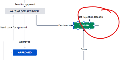

After the approval of the issue you can add a self transition like the example below:
However, the approver must click the transition in order to provide a rejection reason, or simply edit the field and place it.

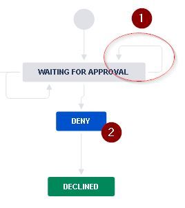

I have a simple workflow requirement: "Approve", "Deny" and "More Info Needed". All users are in the "Service Desk Customers" role. Users can submit requests to their managers (Approvers) for training. When the manager denies the request, I need to show the "Deny Reason" screen with options and description for the denial but the transition goes directly to the "Resolved" status, without raising the custom screen.
As suggested, I've tried adding another status between "Waiting for Approval" and "Resolved", assign the screen to show on the last transition - it didn't work. I also created a loop-back transition as you suggested but that didn't work either - in both portal or service desk. Perhaps, I'm doing something wrong? Thank you much!
-Steve
Steve,
That's what I'm asking! Who is the approver? The managers/agents? If yes, they should be able to see the self transition. But do let me know and will take it from there!
Alex,
Yes, managers are the approvers and they are in the "Service Desk Team" role so they're agents. Requestors are in the "Service Desk Customers" role. Approvers can see the self-transition if I attach it to the "Waiting for Approval" status (item #1 n the screenshot) but then it's a two-step process: click "Reject Reason" transition in Actions, select some values from the screen, then click Deny button.
If I attach self-transition to an intermediate Deny status (item #2 in the screenshot), there's no pop-up screen coming up that is specified in the self-transition. It goes through to the Declined status immediately.
Thank you!
