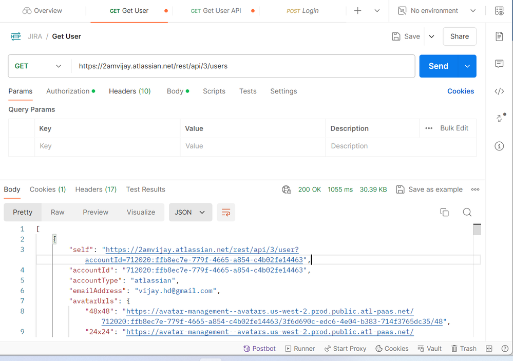

Hello @ajith ,
are you using any search criteria to get users or just blank search. I have used like this
https://xxx.atlassian.net/rest/api/3/user/search?query={{object.Email}}. This searches the users using the email address provided.
Also while making send web request to this end point, the authorization token used should be base64 encoded. If you have not encoded your API token to base 64, i suggest you do that and that should solve your issue.

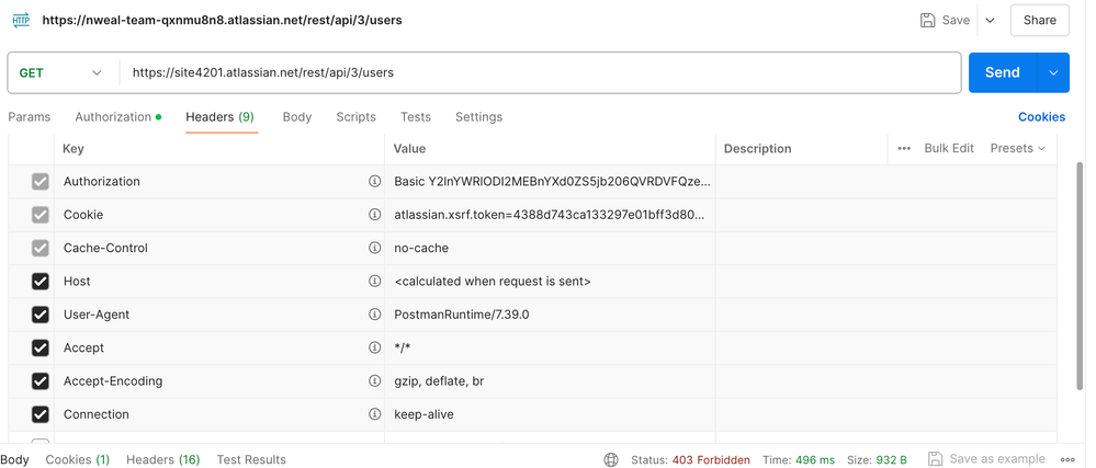

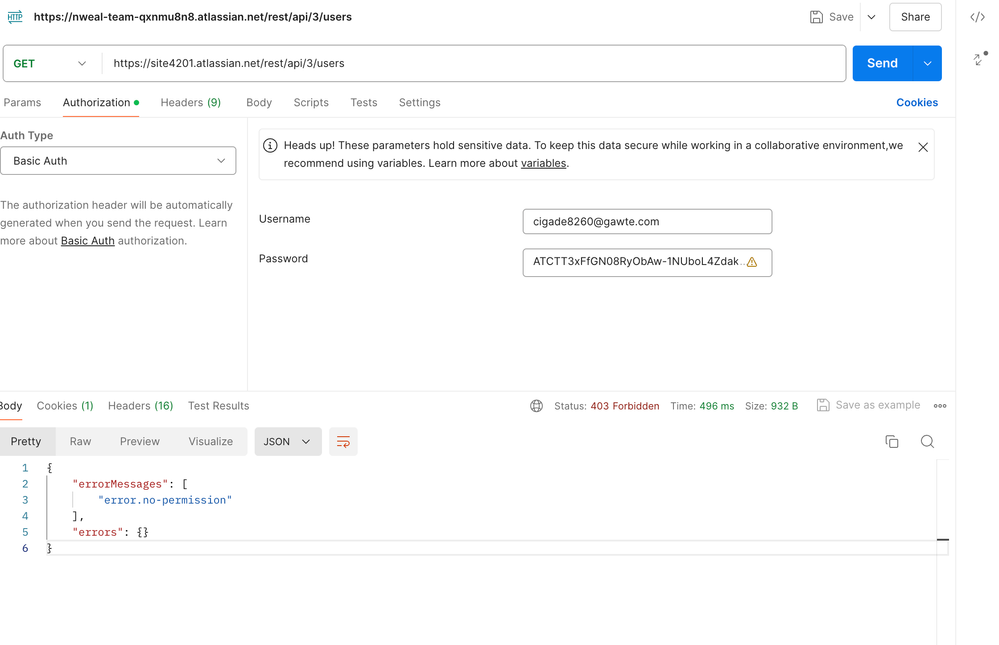

ajith June 21, 2024
@Vijay Dadi Please check the request details below. Please give high priority to this.
URL: https://site4201.atlassian.net/rest/api/3/users
userName :
cigade8260@gawte.com

hello @ajith ,
To access user table, you have to be a jira admin not just project admin. Try the same automation with a user who is a jira admin. Hope this helps !

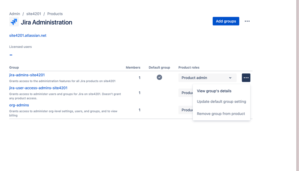

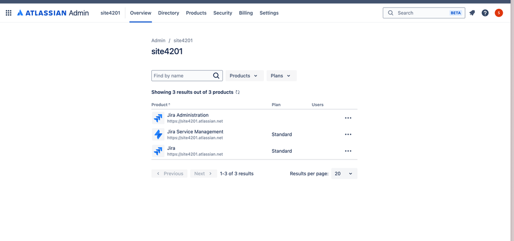

ajith June 22, 2024
@Vijay DadiI created a Jira instance with cigade8260@gawte.com. He is the only User in the instance. He is part of all Jira Admin groups. Please tell me what I am doing wrong here.
