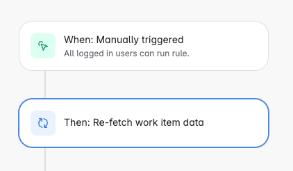

I have not tried this myself but just have you tried creating an automation that just re-fetch issue data?
I would try with a manual trigger first and test it out on a few issues to see if it works. If it works then I would change the trigger to Scheduled and add a JQL that matches the issues I want to re-fetch issue data from (if there's a lot of issues the automation can get throttled so keep an eye on the auditlog for the automation) and then I would then select to run the rule right away. And when done you can inactive the rule or delete it.

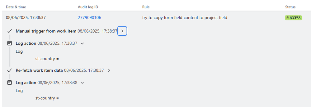

Koen Bruggeman
August 6, 2025
it sounded like a good idea, but didnt work :(
