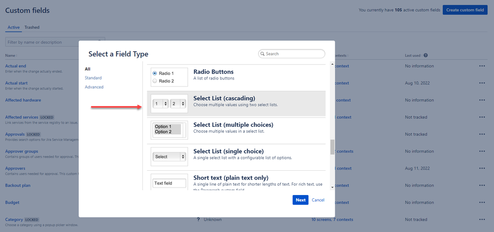

Jira cloud has a custom field type "Select List(Cascading)". You can create the required field and sub-values for them and add it to the required screens.
Got to Admin settings --> Issues --> Custom field --> Add field --> Select "Select List(Cascading)"
Once the field is created, in the custom fields section search for it and click on "contexts and default value"
Now add the parent values click Add and then click configure to add Child values for the field.
Don't forget to click on "Done" after your all changes. .

It doesn't make any difference (Jira Software or JSM), issue custom field creation process is the same. You will need to go "Settings" (System admin right required) clog wheel symbol located at the upper right of your screen, and then select "Issues". In the Issues UI, select "Custom fields" option and then click on "Create custom fields" button. Afterward, select "Select List (cascading)" field type to create/setup your new custom field.
This has nothing to do with FORMs utilization. Lastly, since you posted the original ask in the JSM community, thus I assumed your are using JSM and not just Jira Software.

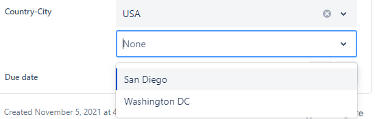

The "Select list (cascading)" field type works like this -
Parent option >> Child options
Example - I have created a new custom field using this field type named "Country-City"
When user use this field, he or she will see the following (via the edit issue within the project UI) -
After the selection is made, it will looks like this
In the Portal Request UI Form (once you also add the new field to the Request Form), it will look like this
Note - One will need to select a parent option first, then the child option dropdown will be displayed and available. IMPORTANT - currently out of the box you can only one parent and one child option selected. It is not possible to select one parent and multiple childs out of the box.
