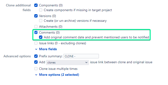

I'm Luka from codefortynine.
If you are willing to use a third-party app, you could try our Deep Clone for Jira.
When configuring your clone in Deep Clone, you can check Comments under Clone additional fields to clone comments.
Deep Clone will clone comments in Jira Software Projects as public comments in Jira Service Management.
Read here for more information.
