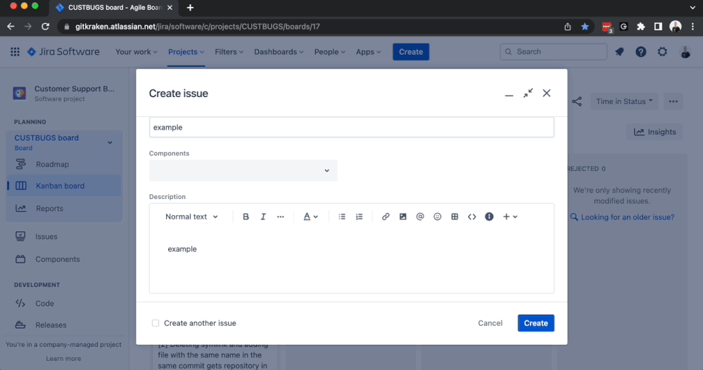

For clarification, I realized that this only happens while the attachment is in line as shown below. Not sure of the conditions that cause drag/drop in the description to simply add the attachment to the attachments section and not in the description, but when doing this, create will show a loading icon as you describe (and I would expect).
