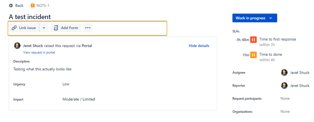

However, for some reason when incidents are created they're still not showing the "escalate to major incident" button. See here:
From what I can tell on the documentation, there should be a new button there allowing me to escalate to a major incident. Any thoughts?
Hi Jeret thanks for your question.
At the moment majority of the new ITSM features are within ITSM project types , which are all classic projects. Next gen templates do not have this kind of ITSM support when it comes to escalating to major incidents in opsgenie.

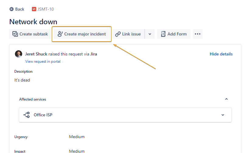

Hi @Liron - I believe Hanna is referring to the "Create major incident" button seen here:

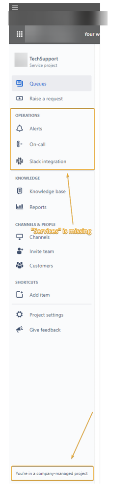

I also have the same question. We have a legacy "Jira Service Management Project"
I've enabled all the "OpsGenie" features, however, I still don't have the button referred to above, I also don't see the "services" link under the "operations" section as expected.

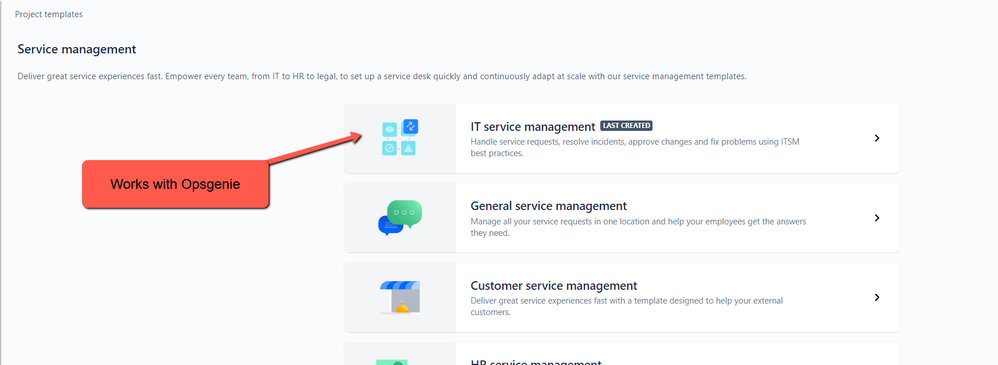

@Jeret Shuck i ended up opening a ticket for support. Here is what i found. Apparently sometimes last fall Atlassian released set of new templates for the service management project. One of the template called ITSM. I.e. other service desk projects created from different templates will have some but very limited Opsgenie features. Try to create a new Service management project using the ITSM template to see it yourself.
There's not a way to automatically switch your project to the ITSM template, but you can use the instructions in this doc if you want to move your existing issues over to an ITSM project:
Also another note - the Create Major Incident button will appear only under specific request type (System-Incident), based on my observations you need to ensure the Issue type has the request type associated to it otherwise the button will also not be available. (We are creating tickets from Jira, not from the portal and request type does not auto-populate in such case).
